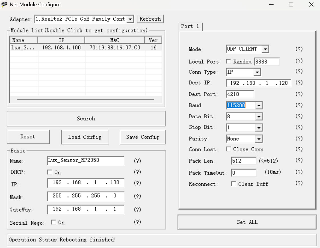

Hello together,
iam new in the Arduino worl. Maybe you can help me to create a smal code. The target is to send the Lux Value from the veml6030 wich is conected with i2c to the rp2350-eth via UDP Ethernet to a UDP Server wich is running on a PC. I try a bit and i can already see the LUX value from the veml6030 in the Serial monitor. But iam not able to send the UDP Telegramm. I look with wireshark but there are no data to see. I use the Configuration tool from Waveshare to configure the CH9120.
 ![image](https://europe1.discourse-cdn.com/arduino/original/4X/3/8/b/38bbea9952cb3cf009795644d755acd8bc38548d.png)

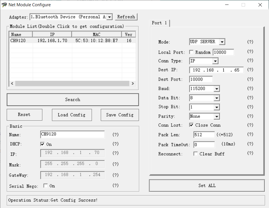

> [@patrick\_bs](#):
> I have a direct connection between my laptop and the RP2350-ETH?
I am connecting via a router (not direct) so using DHCP to get IP addresses
this is the RP2350 configuration I am using
 ![image](https://europe1.discourse-cdn.com/arduino/original/4X/a/f/6/af68465ee3b5299b2b9ea4bff2553cb8bcb3a093.png)
<div class="post-metadata">
**Author:** ![patrick\_bs](https://dub1.discourse-cdn.com/arduino/user_avatar/forum.arduino.cc/patrick_bs/32/1098795_2.png) [@patrick\_bs](https://forum.arduino.cc/u/patrick_bs)\
**Post date:** [August 5, 2025, 9:57am UTC](https://forum.arduino.cc/t/waveshare-rp2350-eth-veml6030-udp/1399374/5 "2025-08-05T09:57:21Z")
</div>
The Ip from the RP2350 is the 192.168.1.70
Mode is UDP Server? and Dest IP you have also 192.168.1.70?
**Author:** ![horace](https://dub1.discourse-cdn.com/arduino/user_avatar/forum.arduino.cc/horace/32/1014299_2.png) [@horace](https://forum.arduino.cc/u/horace)\
**Post date:** [August 5, 2025, 10:21am UTC](https://forum.arduino.cc/t/waveshare-rp2350-eth-veml6030-udp/1399374/6 "2025-08-05T10:21:43Z")
</div>

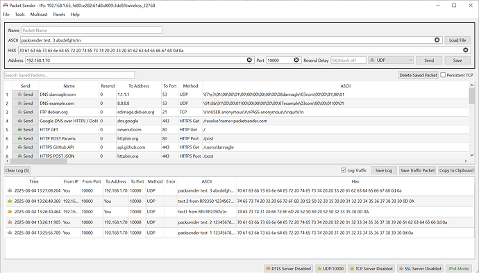

> [@patrick\_bs](#):
wrong screen image!
this is the correct one where the target PC is IP 192.168.1.65 and the RP2350 is 192.168.1.70
 ![image](https://europe1.discourse-cdn.com/arduino/original/4X/1/6/1/161d8b7d2ca82b716eaed4fb3fc3083b7306abb9.png)
packet sender running on target PC
 ![image](https://europe1.discourse-cdn.com/arduino/original/4X/8/1/1/811346c29055022cc7af67f3a48a209e141da7d8.png)
the UDP Server is simply waiting for datagrams
as UDP is connectionless there tends to be little difference in UDP servers and clients in that either can transmit or receive datagrams depending on application requirements
if I set the Net module configure the UDP Client the PC \<\> RP2350 communication works just the same as with UDP Server

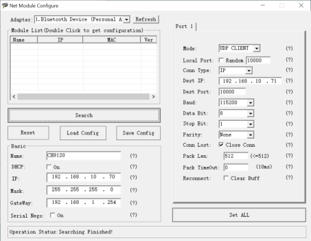

setup PC ethernet interface to static IP, e.g. 192.168.10.71

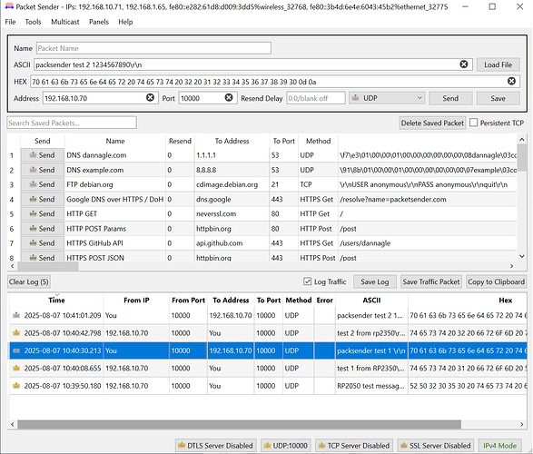

 ![image](https://europe1.discourse-cdn.com/arduino/original/4X/d/2/3/d23a0033b92ccdd16b79fafc9616fcd2e5b14263.png)
using normal Ethernet connection configure the RP2350 using Net Module Configure program - note same subnet as PC static address above, e.g. it's IP is 192.168.10.70 target UDP IP is 192.168.10.71
 ![image](https://europe1.discourse-cdn.com/arduino/original/4X/2/3/d/23da32a5fe03ec5b5299f21a722f4d503950ce1f.png)
connect RP2350 direct to PC Ethernet interface
run Packet Sender to send/receive UDP datagram to/from RP2350
 ![image](https://europe1.discourse-cdn.com/arduino/original/4X/2/1/5/215434c1da24dcd77f1c6ace3bc1fce1b68c7325.png)
run RP2350 code to send/receive datagrams to/from Packet Sender
serial monitor output
```arduino
Waveshare RP2350-ETH Mini UDP test
 TCP_CS 0
packsender test 1
packsender test 2 1234567890
