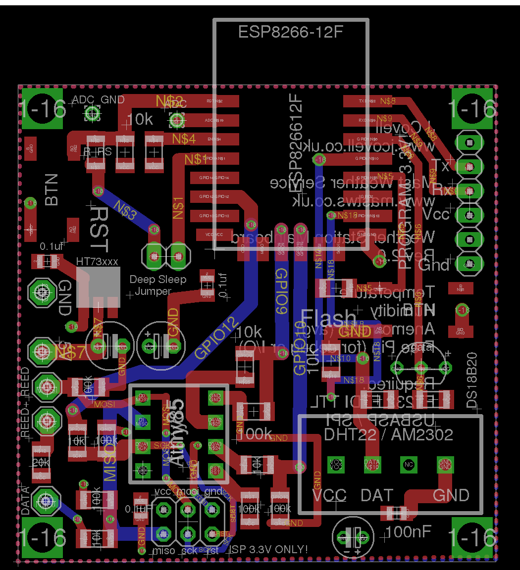

I currently have my second version board on order from the PCB house...
DHT22
DS1820B
Also has an ATTiny85 that has a pin broken out for future use (rain tip/bucket sensor)
with an Interupt pin for an anemometer.
The ESP8266 sleeps for an hour.
When it takes up, it takes the DHT22 readings and the DS1820B reading
It then pokes the ATTiny85 to supply the interrupt count.
All uploads to a mysql server.
My site
How about posting a schematic instead, would be way more useful for review & discussion.
