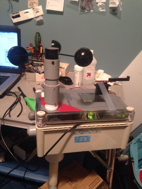

See pics of my weather station. Still in the build stage but almost ready for final paint and assembly.

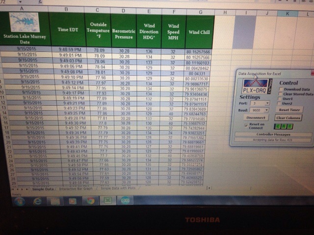

I have 2 apc220 wireless transceivers on the way to make it wireless. Im using the parallax excel sheet to capture the serial data and write it to the spread sheet every 10 min. Fantastic program btw.
