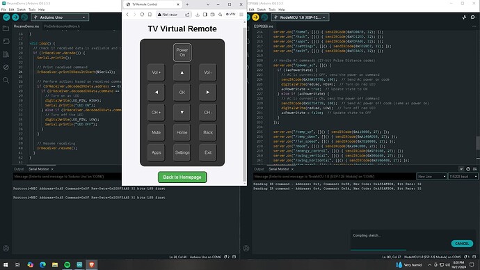

Web Based IR Remote Control Project
I have trouble sending IR code address, command, hex code, and bit rate because when it transmit doesn't match on what I receive. What is the problem in this?

void sendIRCommand(uint8_t address, uint8_t command, unsigned long hexCode, uint8_t bits) {
    // Print parameters for debugging
    Serial.print("Sending IR command - Address: 0x");
    Serial.print(address, HEX);
    Serial.print(", Command: 0x");
    Serial.print(command, HEX);
    Serial.print(", Hex Code: 0x");
    Serial.print(hexCode, HEX);
    Serial.print(", Bit Rate: ");
    Serial.println(bits);
    // Send the command using the correct protocol
    if (bits == 32) {
        irsend.sendNEC(hexCode, bits);  // Send NEC code
    } else if (bits == 27) {
        irsend.sendNEC(hexCode, bits);  // Send LG AC code
    digitalWrite(greenLed, HIGH);  // Turn on the green LED to indicate success
    digitalWrite(greenLed, LOW);  // Turn off after delay
    lastCommandTime = millis();  // Update the last command time
    irsend.begin();       // Start IR transmitter
    irrecv.enableIRIn();  // Start the IR receiver

    server.on("/power_on", []() {
        if (!tvPowerState) {
            sendIRCommand(0x4, 0x5A, 0xA55AFB04, 32);  // Address: 0x4, Command: 0x5A, Hex Code: 0xA55AFB04, Bit Rate: 32
            tvPowerState = true;  // Update state to ON
            sendIRCommand(0x4, 0x5B, 0xA55AFB04, 32);  // Example power off command
            tvPowerState = false;  // Update state to OFF
    // Other TV command handlers...
    // Handle AC commands based on the selected type
    server.on("/power_ac", []() {
        if (!acPowerState) {
            sendIRCommand(0x4, 0x5A, 0xFD10EF, 27);  // Example address, command, and hex code for AC power on
            acPowerState = true;  // Update state to ON
            sendIRCommand(0x4, 0x5B, 0xFD5AA5, 27);  // Example power off command
            acPowerState = false;  // Update state to OFF
