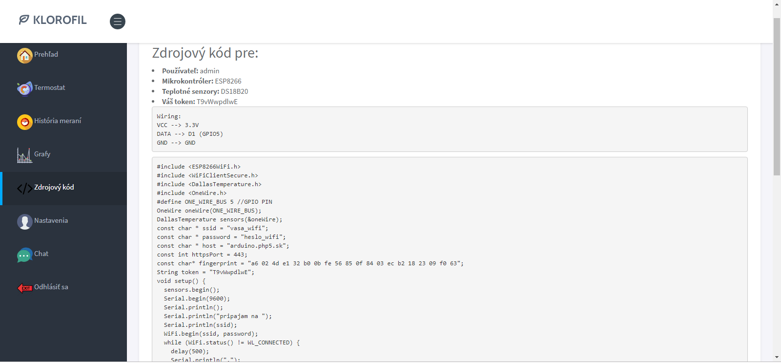

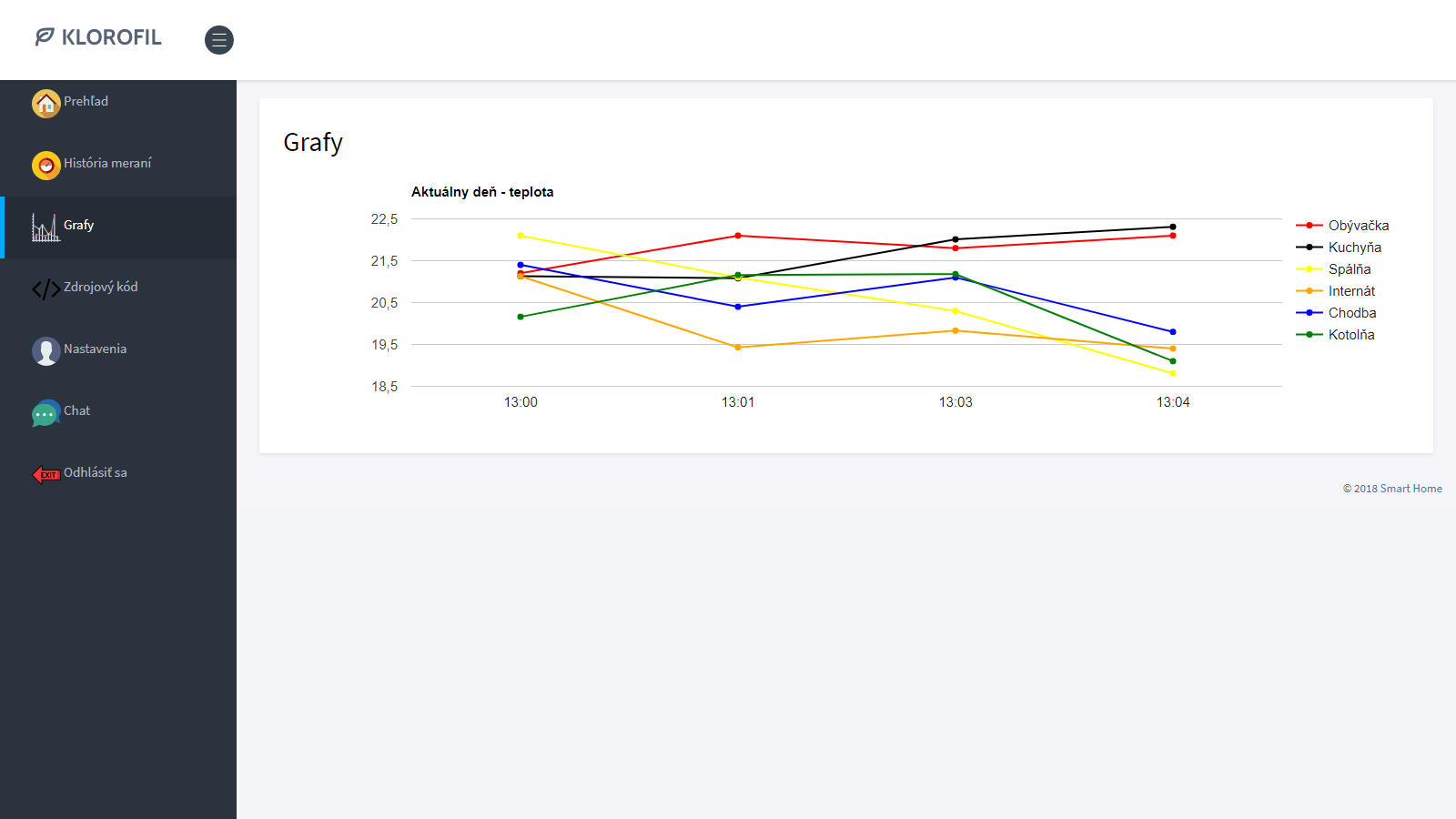

Of course, you can also represent the measured temperatures during the day and plot them directly on the web within 24 hours or 7 days. The site allows you to change the names of the rooms / senses from which data is taken, the page generates the source code for the microcontroller, shows the status of the connection of the board (whether it is connected, the time of the last received information). The user can record temperatures once in 30 seconds.

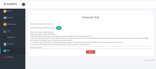

The system also offers real-time chat between registered users.
The application is brisk, it offers an interesting way to collect and represent data in a multiuser web application. Each user has a unique identifier that can upload the data to the page. From the administration interface, spammers (boards that send invalid data can be blocked).
