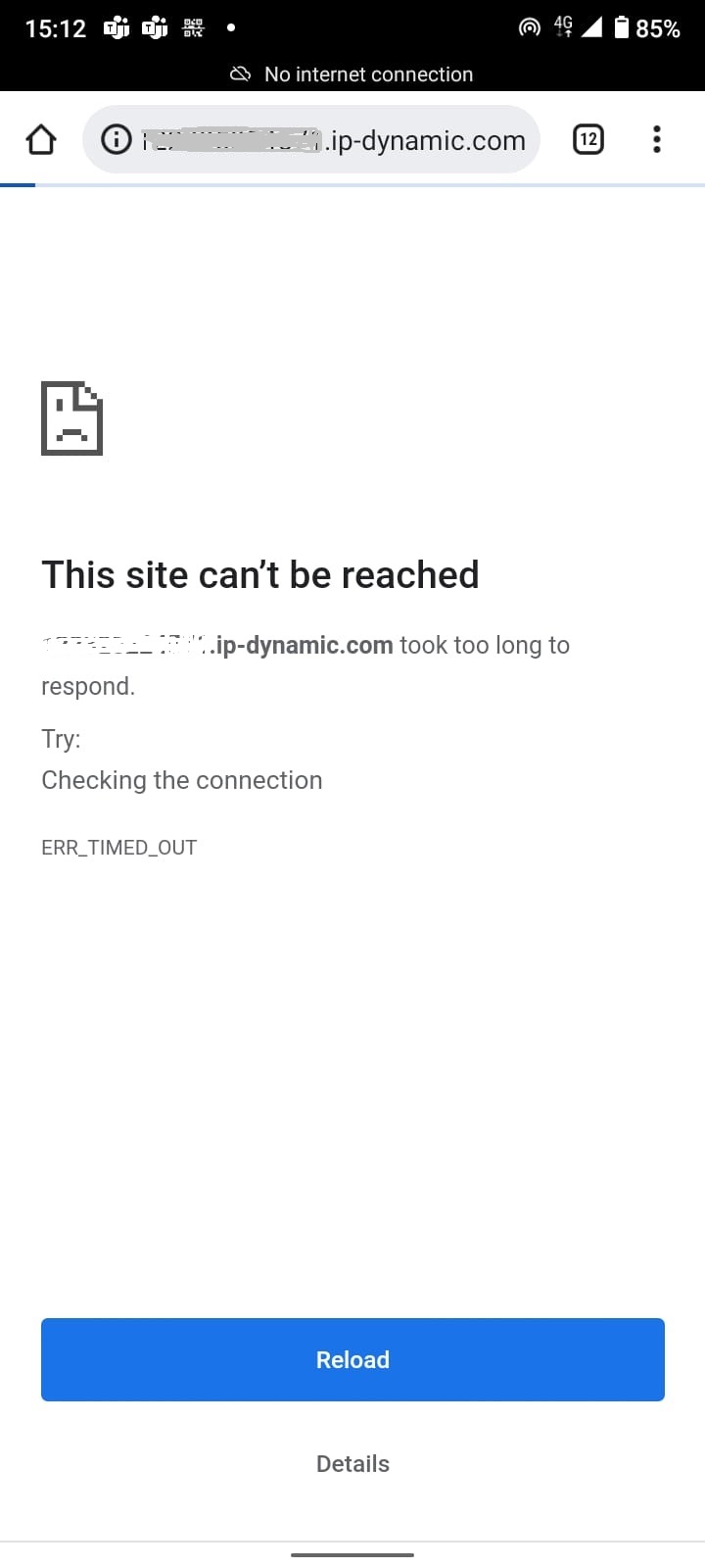

But if I used different Internet Service provider let say TELKOMSEL, I failed when open domain xxxxxxxxxxxx.ip-dynamic.com
To make sure internet it’s OK at TELKOMSEL ISP:
Ping to IP public 125.162.xxx.yyy. result is OK:
BUT when open domain xxxxxxxxxxxx.ip-dynamic.com FAILED:
I’m Using another Laptop/PC also failed(using TELKOMSEL ISP):
Using browser at smart phone also Failed (Using XL Axiata ISP):

Change port 8080 failed
Change port 8000 failed
Change port 1000 failed
Please help me to solve this problem, is there any wrong/missed config at WIFI modem or at Arduino ?

AFAIK, domain names need to be registered. IPs if public should be accessible without any problem from anywhere unless there is IP restriction.

Hi Rohit,
Thanks for your reply, so based on you reply, domain name need to be registered, it mean registered at arduino such as below ?
`char server[] = "http://xxxxxxxxxxxx.ip-dynamic.com ";`
thanks in advance.
I meant that domain names are mapped to a public IP by a DNS provider (such as godaddy or hostgator, etc). And for browsers or other http clients to be able to get to that IP the domain names are looked up against the DNS provider.
Domain name - Wikipedia.
