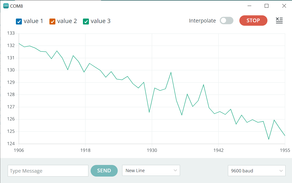

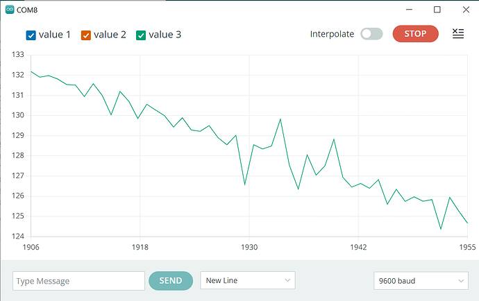

I recently bought a Grove sound sensor from the Arduino Official Store and connected it to Arduino Mega 2560. I wanted to measure the mid voltage I'm getting in silence and surprisingly found out that it is dropping as minutes go by.
It starts at 140 and then eventually goes down to 61, rises to 76 and start decreasing again ...

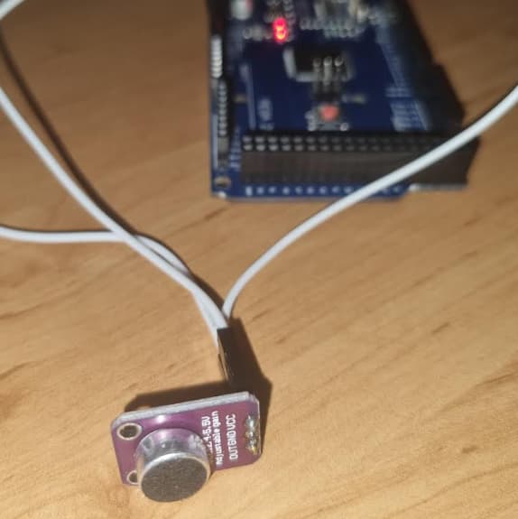

The connection is pretty straightforward too:
I would try to put a resistor (10/22/33 kohm, whatever you have available) between A0 and GND.

I've got the feeling that it actually detects sound through analog output (AO). The signal was rather poor but I thought this was because of the low sampling rate (9 kHz). Before addressing this issue I noticed that I'm already having a problem with the input.

Thank you, but what I need to do is extract the sound from analog input, which can easily be done by (analogRead (0) - soundMid). The problem that I'm having is that soundMid should be a constant but it drops a lot in, say 10 minutes of operation.

Is this your sensor. This diagram.
The output seems AC coupled (220n cap).
That means that the Arduino input is floating (for DC).
One way to fix this is to mid-bias your analogue input mid-voltage with two 1Megohm resistors. One from pin to ground and one from pin to 5volt.
Leo..
