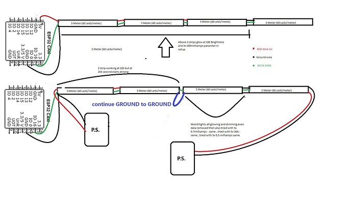

My schematic
Please let me know if any other requirements or suggestions

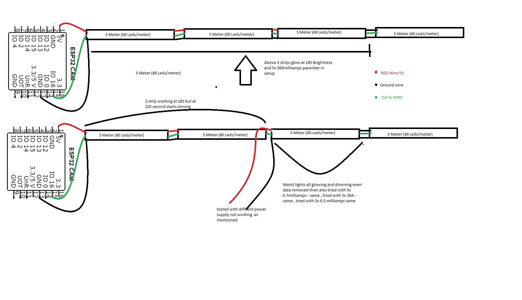

[EDITED TO SHOW CONTINUING GROUND WIRE
i tried with 2 LED strips from the back of the strips but same full bright flickering lights glowing with only the single 5 meter second strip and first strip glowing perfectly
I forgot to draw the line sharing the GROUND pin going from the first group to the second group.

@xfpd below i tested but why it is happeing i am unable to identify
This above i did to test my ATX Power supply
i am expecting for this schematic which i tested with ATX is to have either dim light througout the strip of 5meter if 300 * 60mA is the calculation as 18A required or turn the strip perfectly .
also i have 3 ATX power supply and 1 is new , but all the 3 of them showing same behaviour
If the drawing on the left is true (up to 2m only, rest are not glowing) and the drawing on the right is the same, you have a broken wire...
  1. Check your power wire... all power pads should have continuity... jumper past any break in continuity.
  2. Check your ground wire... all ground pads should have continuity... jumper past any break in continuity.
  3. Data... Where the lights stop solder a jumper wire on the DOUT pad, skip one (or two, or three, ... ) LED, solder the jumper on the next DIN pad.

How about you first start out with adding a TTL chip like the 74HCT04 (thru a gate 2x) to lift the 3.3v logic level up to 5v.
Then provide power to the start of the strip and the ESP32 and make sure they share GND, and inject power every meter or 2. Set all leds to 'WHITE' and see where they start to look a little brown.

Have you added the level shifter TTL chip to the circuit yet ?
I know you are referring to this Resinchem Tech: Standard Wiring Diagrams will share results if it resolves my issue as today i put my purchase ,
Thanks
No i am not ! Not a level shifter per se, just a simple NOT-gate powered with 5v. a 74HCT04, and run the signal through 2 of the gates, inverting it twice to have the original logic again. The input will respond just fine to the 3.3v logic levels of the ESP32, and the 5v output logic level is sufficient to trigger the WS2812B's
I think that it worked initially is that because of the lack of power, the WS2812B were powered with significantly less than 5v.
Thanks @Deva_Rishi it worked so my Leds are of 60 Watts and i have 5v 60 Amps PS so it is enough to power all my 4 LED strips WS2812B even one more can be powered + power Injections , though I am using I2C Level Shifter as getting much better results with high brightness .
