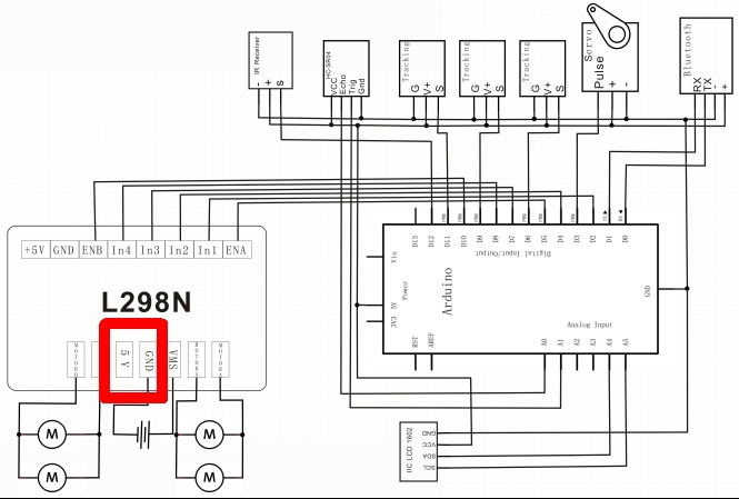

Dears, Can you help please? I've made a code to control a robot-car using an accellrometer in my smartphone (with RoboRemo App) and everything worked fine. But when I added a few lines of code to control in addition one servo, then right wheels stoped working correctly - they turn only in maximum vertical psoition of the smartphone.
Here is the robot: LINK
The scheme: LINK
The source of power for the servo - I attached a scheme
And the code:
Have a look at the Servo library reference page, and see what it says about PWM.
YES!!! YOU'RE RIGHT !!!
"On boards other than the Mega, use of the library disables analogWrite() (PWM) functionality on pins 9 and 10, whether or not there is a Servo on those pins."
T H A N K Y O U !!!
