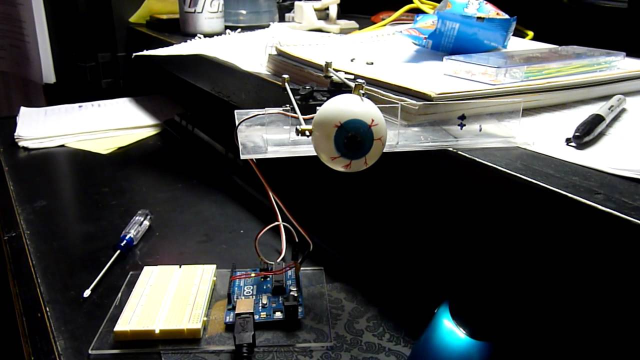

Ok so it must be something with my breadboard or hookups with the stupid wall wart. I hooked the servo's into the Arduino directly and IT WORKED!!!!!!!!!!!!!!!
Now to tweak it and transfer the results to some "subject of hacking" aka a mask.
Little video.
