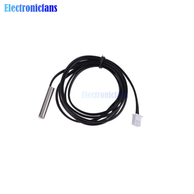

you can find thermistors that are in a small can with some wires to make it waterproof.
thermistors are super easy to use.
the incorrect statement was "the DS18B20 is analog"
the DS18B20 is digital, but uses 1 wire.
easy to use and comes in a water proof version

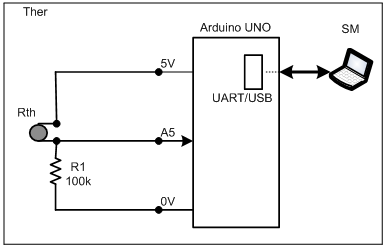

So, the calibration process of the thermistor would involve:
Figure-1: Incorrect/faulty Wiring diagram of thermistor
Figure-1: Corrected wiring diagram of thermistor.
1. Place only the thermistor element in the ice water (use temperature proof wires to maintain connections of thermistor with R1-terminal, A5-pin, and 5V); also, place a thermometer in the ice water. Measure voltage at A5-pin using a DVM. Record this measurement as: A(T10C, V1).
2 Boil the water until it starts evaporating. Measure voltage at A5-pin using a DVM. Record this measurement as: B(T20C, V2).
3. The unknown temperature point is: C(T0C, V).
4. Now, find equation of T in terms of V; find relation between V and analogRead(A5);. Let the VREF voltage of the ADC be at DEFAULT (5V).
5. Finally, we will have an equation for T in terms of analogRead(A5);. We can present T in integer/float format.
GolamMostafa:
Figure-1: Wiring diagram of the thermistor
This shows A5 connected to the 5V rail. You want your ADC connected to the other side of the thermistor, where the thermister forms one leg of a voltage divider between Vcc and ground and your analogue reading comes out the middle.

I thought it was normal to have an additional resistor to make a divider.
Nick_Pyner:
Thnaks to both @gardner and @Nick_Pyner for pointing out the issue.
While typing, we have typo errors; while making a drawing, we do have errors; unfortunately, there is no saying in favor of that 'this is an error'.
If wished, it can be viewed as this way -- there is an omission (by mistake) the connection of the junction-point of Rth-R1 with A4-pin. Signal of A5-pin (Figure of Post#14) can be used for the real-time adjustment of the VREF value of the ADC.
The corrected diagram is posted below:

Diagram looks correct but that just doesn’t make any sense. If only because you normally want Vref to be equal to Vcc (if doing ratiometric readings like in your case), or as stable as possible (when reading e.g. the TMP36 or other sensors with absolute voltage output).
