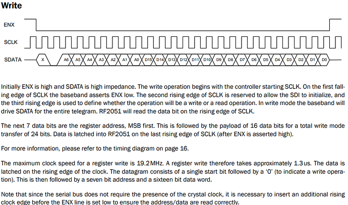

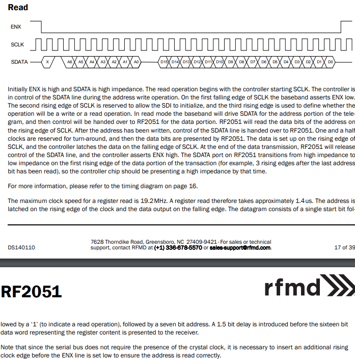

I am trying to use my Feather M0 to interface with this RF mixer [RF2051 (https://www.mouser.com/datasheet/2/412/f2051_data_sheet-1398223.pdf).
The documentation states that the registers on the device are programmed using a 3-wire serial bus. The wires are ENX, SCLK, and SDATA.
Screenshot 2024-08-24 032604
The question is what communication protocol would I use? How would I create a read and write function to communicate with the device? Would I use I2C or SPI? I assumed SPI so I tied the MISO and MOSI lines with a 3.3k resistor and connected ENX to one of the digital pins.

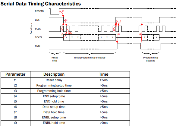

I tried writing a read and write function, but it didn't work. Is it because of a timing violation? Or is my code wrong?
I appreciate any advice or guidance!

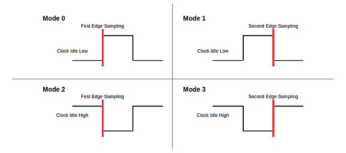

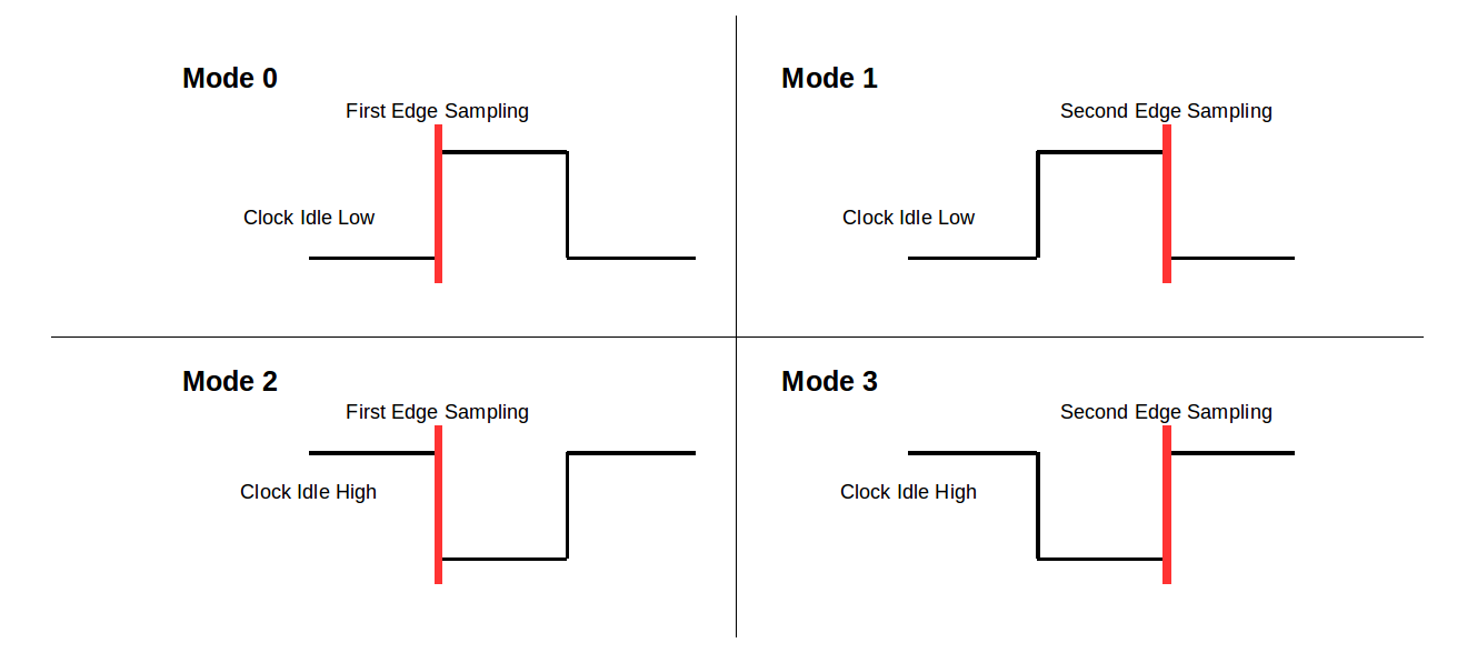

Looks like SPI 16 bit transfer.
Edit: Take a look at this article, especially the section on clock polarity and phase.

I just bit banged the bits manually and got it working. Thanks.
Have you tried 3-Wire half-duplex SPI?
