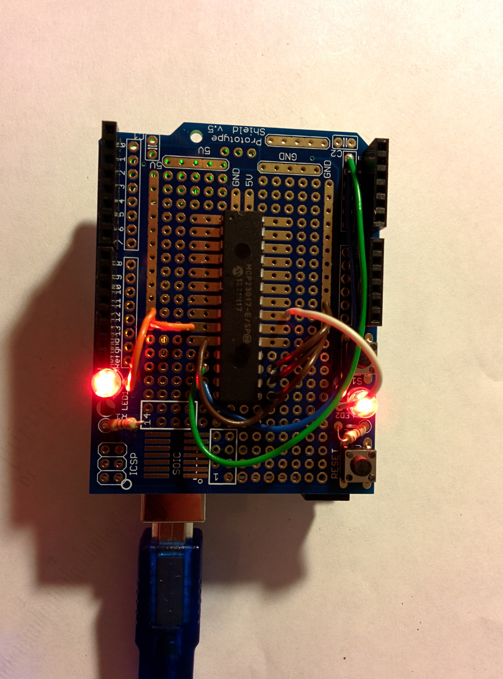

Olikraus does have a point but if the screen is compatible and does in fact work with an Arduino Uno then this is a good diy shield to help you with with the many inputs that the screen has: http://www.instructables.com/id/Extra-IO-Pins-For-Your-Arduino-Uno/
