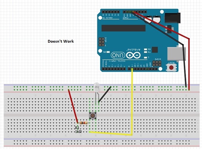

So without going into too much detail about all the rabbit holes I have gone down I am at a point where I am trying to reproduce the the functionality of the button using a breadboard only. While doing this I have stumbled upon what I assume is a very basic issue but I don't have a fundamental understanding for why.
This is a simple button circuit with an LED attached, when the button is pressed I want the LED to light up as well as change the state on Pin 9. I am using the internal pullup on pin 9 and will print HIGH or LOW to COM4 based on the button being pressed or not.
So my questions is this: Why does this work when the LED is not in the circuit, the serial monitor shows the state changes, all is good. When the LED is attached the voltage doesn't drop to zero and the pin stays HIGH, the LED does light up.
Measuring from PWR to Pin 9:
Button not pressed = 0V (no LED)
Button not pressed = 0V (with LED)
Button pressed = +5V (no LED)
Button pressed = +2.38V (with LED)???

Measuring from Pin 9 to GND
Button not pressed = +5V (no LED)
Button not pressed = +5V (with LED)
Button pressed = 0V (no LED)
Button pressed = +2.73V dropped (with LED)???

Same results, with the new code:
No LED I get Low printed when pressed and High when I let go(my code just checks the state every 100ms and prints High or Low)
With LED - Nothing printed at all.
HOLD ON - The new diagram wasn't there yet.....Need to check again.
I had it wired up that way before and yes it was ok. I don't remember exactly why I moved the LED but I did and when it didn't work with the same results I got confused.
So this questions isn't about how to get the button, led and high/low output, the question is why does it work with the LED before the switch or without and LED altogether but not when the LED comes after the switch?
The way you had the circuit wired resulted in a non logic level on pin 9.
The LED and the 1k were creating a voltage divider when the switch was pressed.
2.2v across the LED and 2.8v across the 1k.
2.8v is not a HIGH or a LOW, it is an indeterminate level.

That helped point me in the right direction, I have been able to replicate the functionality of the 3 pin LED arcade button. The two LED's stay lit all the time and when the button is pressed the pin goes LOW.
