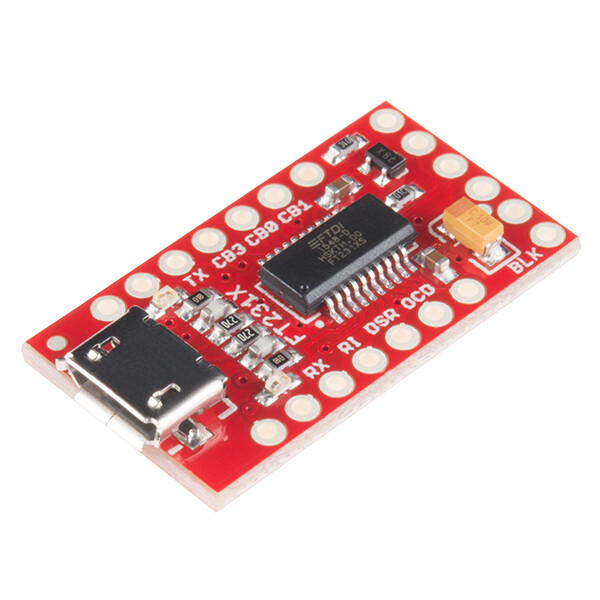

I think you probably mean break out modules, which often ship with the headers loose, so you can make your own choice:
