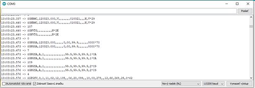

In my test program, I have an unexpected delay (approx 100 ms). I am trying to read data from GPS (as NMEA sentence) and parse it. Currently, the program reads the data and if it is NMEA sentence, it try to parse it. The problem is, that I get a delay of approx 100ms between some of the messages.
The baud rate of the GPS is 9600, could this cause the problems?
My approach is to parse GGA sentence, and resend to different serial port (USB) a modified custom sentence with added sensor data as soon as possible (should looks like originally from GPS - so synchronized)
My output looks like this:
The first sentence is printed directly after the byte has been received. The second sentence is printed as a String after the full sentence has been received.

I'd guess it's the baud rate. An NMEA sentence can be up to ~80 characters. At 9600 baud, that'll take at least 80 mS, so that accounts for most of it. Your other sentences with no data in will be a bit faster of course.
