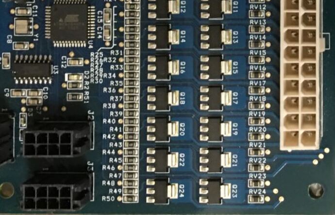

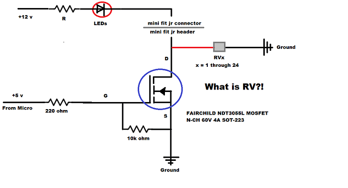

Hello, I am trying to recreate this circuit on this LED light controller.
It uses N Channel mosfets to toggle all the LEDs on/off, blink. pulse, etc. There is a connector and the original manufacturer has always done a good job with ESD protection on all things coming/going to connectors. So I think this is a Reverse Voltage blocker / ESD protection of some sort.
I have taken the time to draw this up in MS Paint. The "RV" goes from Drain to Ground.
I have found what looks to be the correct item, but there are ranges of which protection it provides. Why can't it be one size fits all. haha They are called "AVX Multilayer Ceramic Transient Voltage Suppressors" by TransGuard.
I have connected a voltmeter to the item. In one direction there is no reading. If I reverse the probes I get about 11M Ohms. If that helps?
Here is the datasheet for what I think RV is - https://datasheets.avx.com/tguard.pdf
They are so small there are no markings, only RVx (x = 1 - 24 as there are 24 pins on the connector) on the circuit board. I've looked around but ESD findings on N Channel Mosfets seem to go to the Gate and Drain and Gate? Not Drain and Ground. Perhaps they are protecting against something else?
If someone can take a look at my drawing, and the pdf, oh and the Mosfet used is "FAIRCHILD NDT3055L MOSFET N-CH 60V 4A SOT-223" and validate my research and hunches, I would be grateful.

Probably, I think RV is a varistor.
It provides ground path when rated over voltage is applied and protects the MOSFET.
(That a momentary overvoltage such as electrostatic discharge.)
It is possible that a TVS diode with similar functionality is implemented.
These days, it often replaces varistor.
A picture of the original circuit will help.
A simple hand drawn circuit would have sufficed and been easier and quicker to make.

Pictures of the circuit and the whole board.
Rv just looks like a resistor to me , maybe in series with the connector ?? are you sure your circuit diagram is correct ???
You might be better off designing what you want to do from scratch .
Well their marked RVxx not Rxx like the other resistors on the board, and RV is the standard designator
for a varistor. Reference designator - Wikipedia
TransGuard shows how they mark all of their varistors here on page 2.
Probably the markings are there but barely visible. Some could be on the side or underneath depending on which side is facing down when soldered. You'll need a good digital camera, lots of natural lighting and zoom in at different angles to identify the markings. I sometimes also use a bright led flashlight at a certain angle to get an enhanced image. One thing for sure, the varistor will have a peak clamping voltage less than the 60V MOSFET rating.

I want to attempt to recreate this board. It appears to be 3 layers. My first 3 layer board.
J6 is the ISCP header to the Mega6224PA. The fuse bits are not locked.
J1 is power to the board +12vDC,
J5 is Positive power to anodes of the LEDs
The big connector comes from the cathodes of the LEDs

I'd like to know why I get really high resistance readings on the multi-meter when the probes are one way, and nothing when they are flipped around
If you are measuring it in circuit, then there could be other components connected to it, how many layer is the PCB?
If you measure again but with your DMM in diode test, what do you get?
Tom.... :slight_smile:
Eddiie:
I'd like to know why I get really high resistance readings on the multi-meter when the probes are one way, and nothing when they are flipped around. From what I've read, they are non-polar. But then again there are two types, Metal oxide and I guess non-metal oxide..? The non-metal oxide I think are polarized and have a band that marks them. But I sure cannot find it on an 0805 (I think it is 0805) package!
If you're probing the part in circuit, it's in parallel with the MOSFET's drain-source, which has an inherent body diode. So you'd be measuring the MOSFET's diode in parallel with the varistor, which would show polarization.
Well, I looked closer and still cannot find any markings. However, thanks to everyone's help here I am confident these are Varistors. The high resistance, the markings, the sample diagrams all seem to line up.
The question now is what Varistors do I use? The input voltage is 12V That's all I know.
