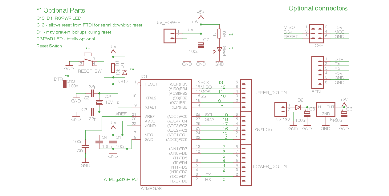

Here's a similar Eagle bare minimum board

Here's a similar Eagle bare minimum board...
The thread title asks for a 'Schematic Tool'. The diagrams produced by Eagle are more closely related to 'wiring diagrams', they are not at all useful as schematic diagrams.
Example:
If you look at pin 19 of the IC in the diagram in reply #3 you can see that it is connected to pin 6 of the 'Upper_Digital' connector. There is no clue that it is connected to anything else. You must scour the entire drawing (and hope you didn't miss anything) to find any other connections.
If you look at pin 19 of the IC in the diagram in reply #1 you can easily see that it is connected not only to pin 8 of Port B but also to pin 3 of the ICSP connector.
Schematic diagrams are designed to make the signal flow of a device easier to comprehend, wiring diagrams are designed to make the construction of the device easier.
