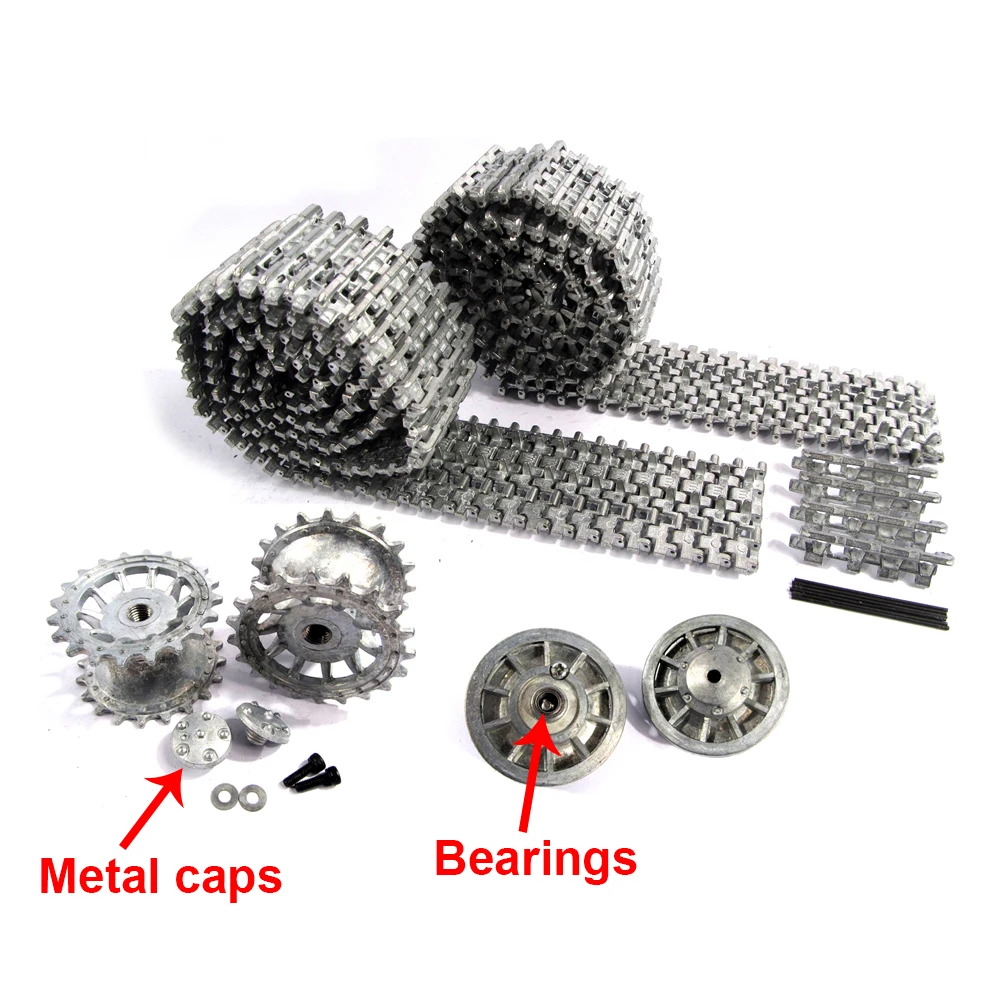

**I used these metal wheels and tank plates too: https://ae01.alicdn.com/kf/HTB1E.R7OFXXXXcRXXXXq6xXFXXXu/Mato-Metal-black-Tracks-sprockets-early-with-metal-caps-idler-wheels-with-bearings-for-Heng-Long.jpg. The radios of this wheel is like this: HL Tiger 1 49.82mm
