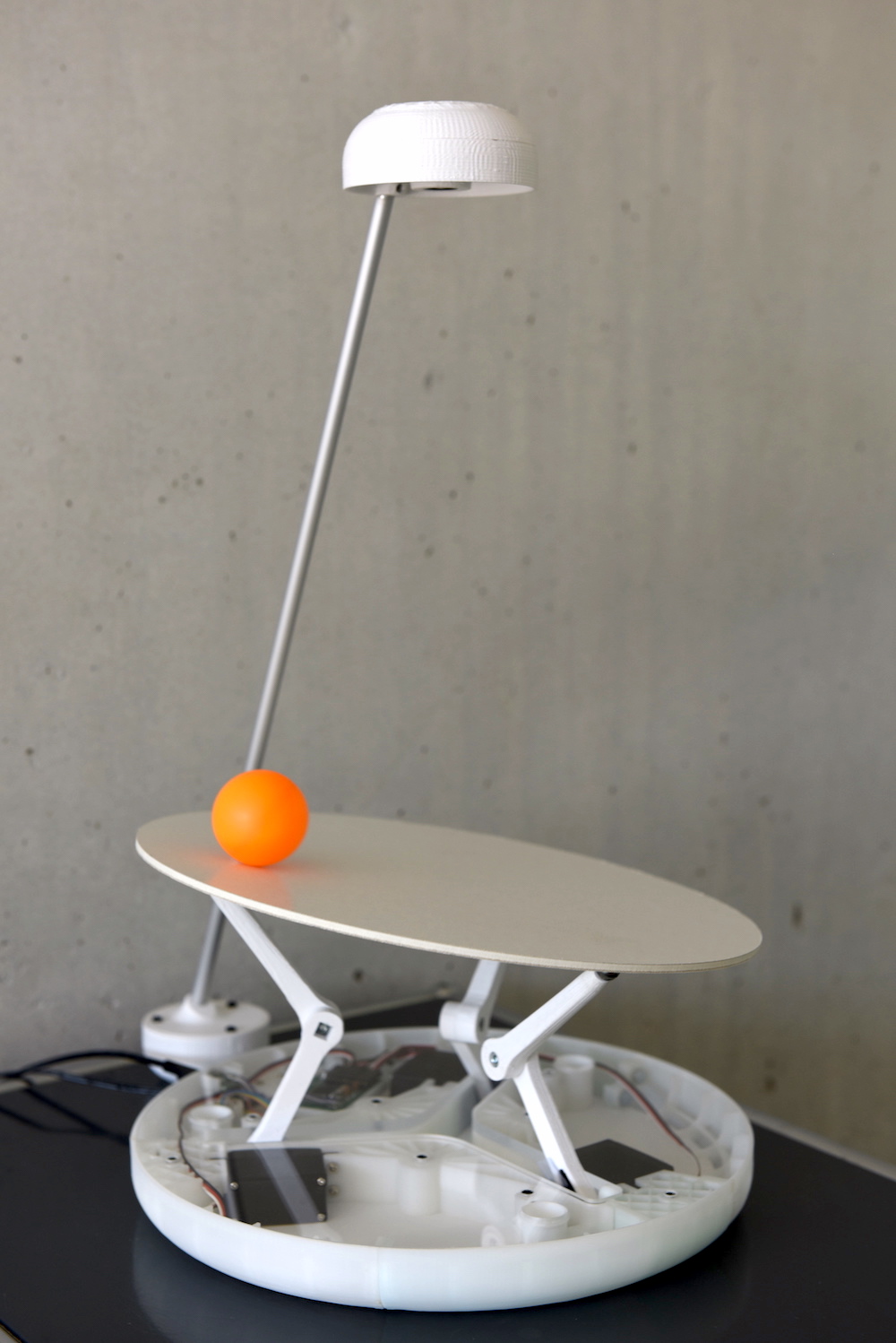

I was wondering if anyone could tell me what mechanism/motor is involved with the individual arms in the links I posted above? I'm interested in building just the arm movement with Arduino, but I'm not sure how/what is involved on the mechanical side. Thank you!
To me, they seem to be simple servo motors with 3D printed legs that are going up to the tabletop. I am not exactly sure what the joints are on the legs though...
Google "Stewart platform"
Expand!
They had better be durable servos! There appears to be a fourth one in the base. What is it doing?
Most Stewart platforms I see have no “retracting” ability. The movement in the joints of the arm allow the platform to be completely flush with the base.
I’m really interested in how/what is being used to move both the joints and bottom legs.

Not sure what you mean. It clearly is a common "servo" as used in RC vehicles. Given the leverage, it will need to be a quite heavy-duty one.
I am not sure whether the joints can be simple spindle bearings or (some) need to be ball joints.
I am also interested in how the device is seemingly bending the middle joint... maybe it's spring-loaded and the tension of the other joints when a servo bends allows it to stretch or compress the other springs? I think the small joints just under the tabletop are just ball magnets.
The linked website says high performance servos

Not spring loaded, its just a hinge - the mechanism is perfectly constrained, 3 degrees of freedom and
3 actuators.
