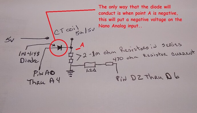

Please post a wiring diagram. Hand drawn is fine, Fritzing is not.
His Ct sensor detects a locomitive entering an area on a model railroad and turns an led on, on the circuit board or on your control panel. Then once the loco leaves that area the led goes off after a few seconds . The first sketch works correctly for one sensor. My modified sketch works correctly for the first sensor connected to pin A0 and D2 for the led . None of the other leds on pins D3,4,5,6 come on when a loco is in their area. I have tested each one of the sensors with the first sketch and they operate as they should. So what is missing is in the code and I have no idea what else needs to be modified in it to get all 5 sensors working . I am using a nano to run these sensors, detection input is on pins A0 thru A4 and led output is on pins D2 thru D6.

Haven't you got the diode in the circuit the wrong way around?
Can you post a link to where you got the code and info?
CT coils are normally biased at mid-rail as the output is AC. This appears to be missing from this circuit, biasing at 5V will mean the CT output will go above 5V and cause damage.
Load (aka burden) resistors for a CT go across the CT secondary. Again I don't see this in the diagram.
I found the YouTube
The guy has no idea about how a current transformer works.
The only way it works is because of the DCC signal being basically AC.
And as @MarkT has said 5v bias and no burden resistor, not good for the controller.
Those two series resistors are 2 x 1M Ohm.
In effect the circuit is using the current transformer as an antenna, not a current sensing device.
I probably drew the diagram wrong . I assembled the circuit as he described and it works.This maybe not the way it should be done then . I guess I need to do more research before going any further. Since what you guys are telling me they could cause damage.
