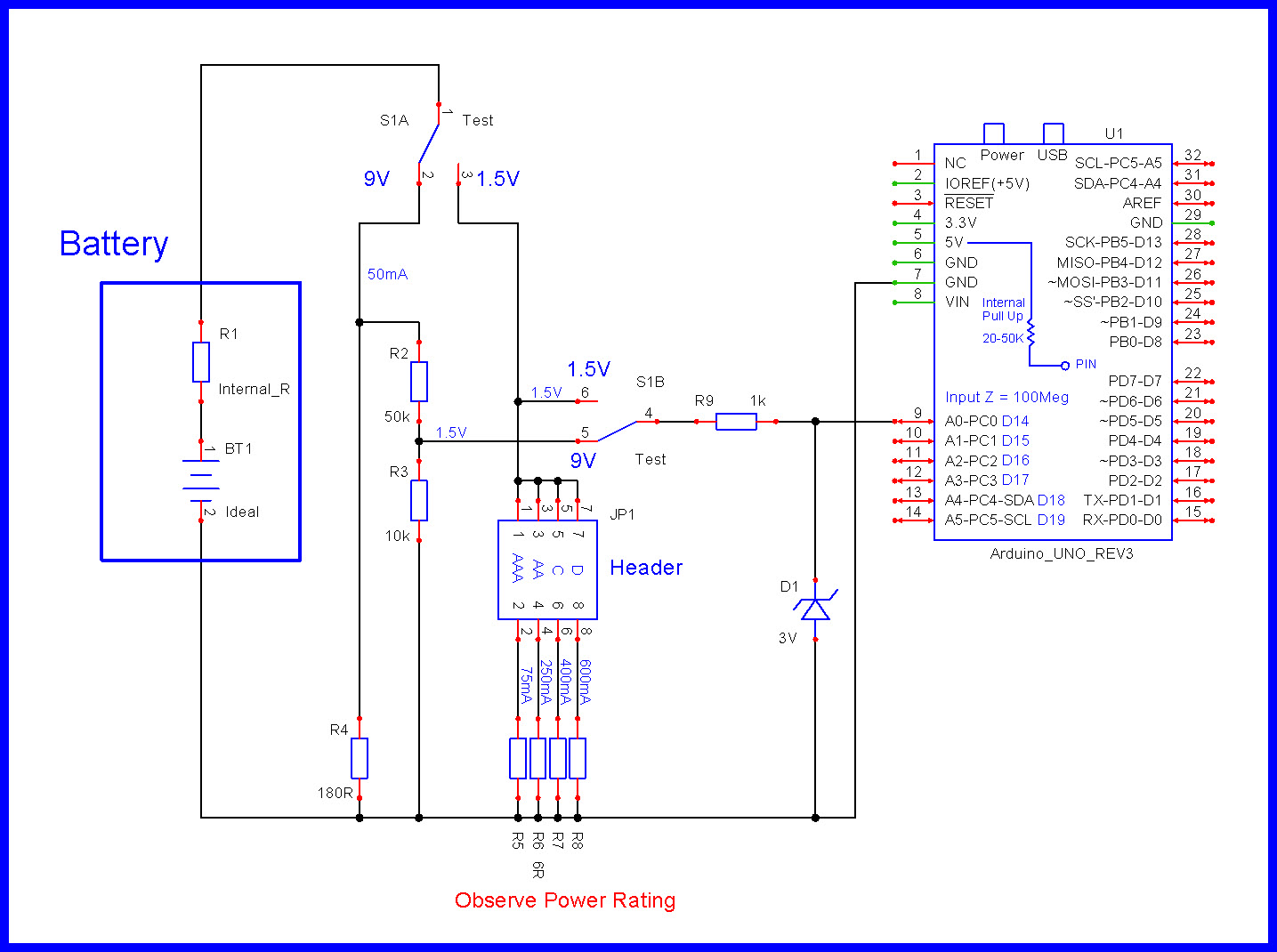

Well . . . the mAH rating of these 1.5V cells are quite low so R2 would need to be increased in value accordingly.
You could have a jumper option for all possibilities :thinking:
