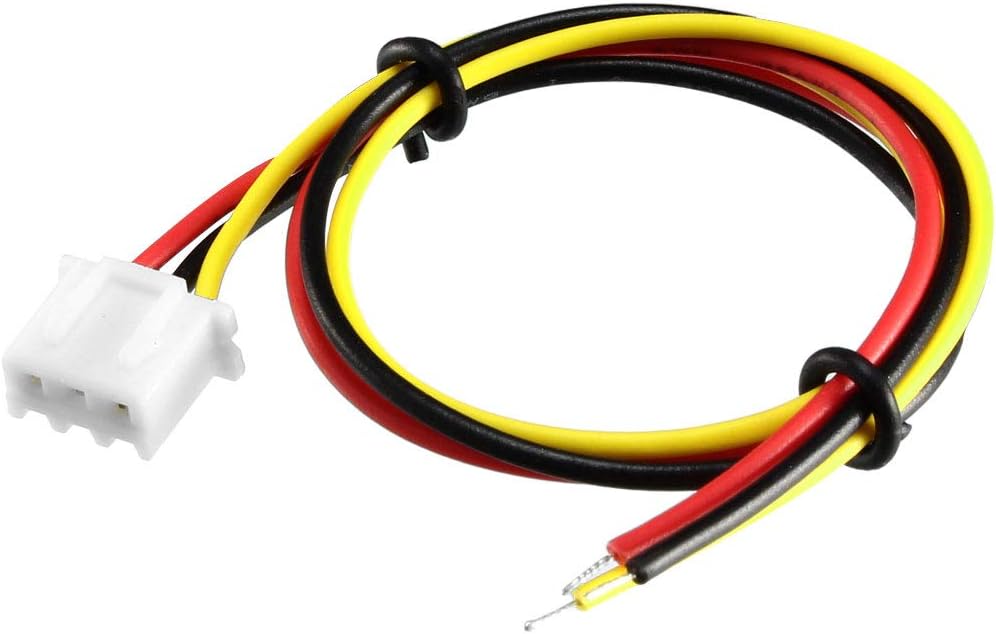

See if this helps
https://www.mattmillman.com/info/crimpconnectors/common-jst-connector-types/#gh

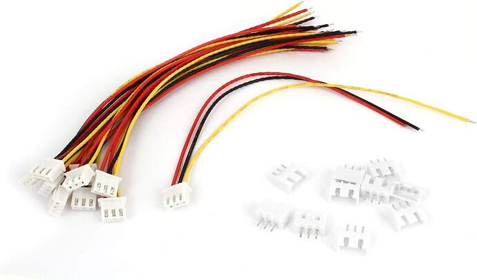

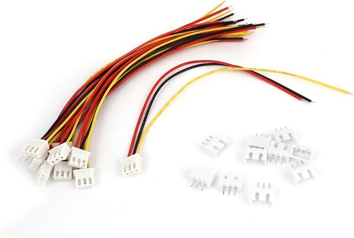

Maybe this https://amz.run/9bGq
Thanks for all the links. Some are not 3-pin, others are different pitches.

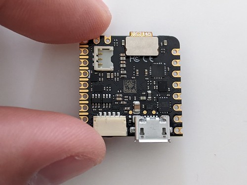

Which seem to match the receptacle of the Nicla Vision:
You can buy the housing and wires separately at Digi-Key or Mouser.
Scroll to the bottom to see the associated wires with contacts
That is the part on the board, you need the mating part.
Thanks. Not sure which part is which on Mouser. Updated post to include both.
Now I'm also confused. Which part do you want, the part that is on the board or the part that plugs into the part that is on the board?
Your (DigiKey) link has a good picture. I do need "ACHR-03V-S" on the battery side.

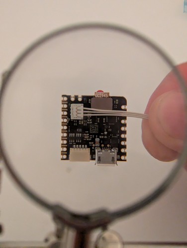

Ended up ordering at DigiKey (455-2198-ND, 455-3345-ND). Thanks @jim-p for mentioning the wires. Despite the small size it's quite easy to assemble them by hand.
