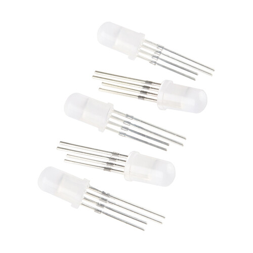

Looks like for those dimensions, thru hole LEDs will be needed.
These are actually in stock
Crummy datasheet - can't tell the pin spacing. Or the hole diameter needed.

How can I get 4 of these?
That one does not have RGB LEDs, just single color.
