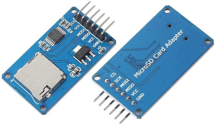

How about using a micro SD card instead? That USB drive could indeed be the kind that takes a micro SD card (also known as a micro SD adapter), which any regular Arduino can readily deal with. Adapters like this one are cheap and easy to come by:

I would seriously reconsider and use a SD card. This will reduce the requirements on the Arduino board and the modules like the one wvmarle showed are cheap and easy to use.
