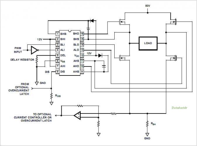

I missed the part where you said it was a school project. There are H-Bridge driver chips available that can manage the "shoot-through" for you. They also use a charge pump to generate the high-side gate drive, so you can use all N-Channel FET's. Also it won't let you turn both FETs on in the same leg.
http://www.intersil.com/en/products/space-and-harsh-environment/harsh-environment/half--full-bridge-and-three-phase-drivers/HIP4082.html Their application circuit as drawn works quite well. I have personally used it to drive some 180A FETs
http://www.st.com/web/en/resource/technical/document/datasheet/CD00001950.pdf
Using this chip makes the task more reasonable since it has adjustable shoot-through time delays built into it. If you stay with the Arduino's 400Hz PWM you shouldn't have much trouble. If you raise the PWM to 10kHz or so, the storage times of those parasitic diodes in the FETs will generate a current spike that will show itself as a lot of power dissipation.

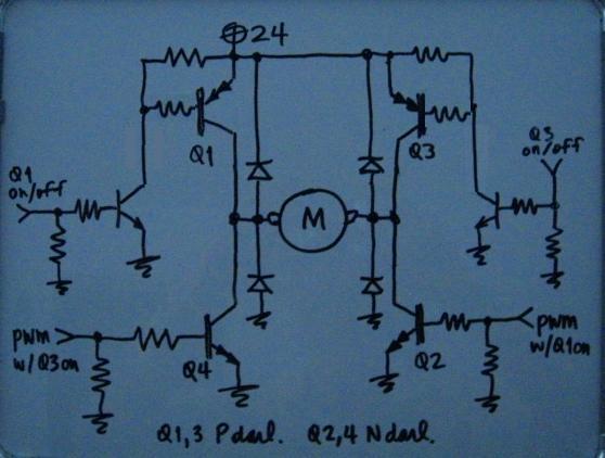

Yeah, he still wants to run at 24V! Are you stuck on 12 for some reason? Also it's a pretty lame design since you have no way to PWM the bridge or allow any delay for shoot-through. If I was his professor, I would give him a "D" for that design.
rmetzner49:
Then what type of circuit would you recommend? I have to use the BDV66B and BVD67B.

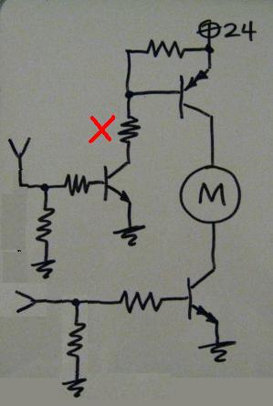

Those alone won't be enough.
Other components are necessary.
I've attached a "half-bridge."
adding dwg w/ 2 control inputs, omitting previous w/ only 1
changed place of darlington base resistor (disregard previous)

Well, here's the rest of the circuit.
It's rudimentary for sure.
Shoot-through and other concerns can be addressed in software (no slamming from FWD to REV, no having FWD Hi and REV pwm going at the same time, stuff like that.)
"newbie" isn't designing, he's trawling for others to do that, like it's a piece of cake. Well, that's all for me till Jimmy Doce starts par-ti-ci-pa-ting.
changed the placement of the darlingtons' base resistors (better now.)

Using FETs gives you absolutely the most efficient bridge. The transistors you've chosen come with a penalty: They will at best give you a 2V drop since they are Darlingtons. Since you have two on at any given time, you are hit with a (4V * 3.5A) or 14 Watt penalty right off the bat, and you haven't added switching losses.
Also, the parts count goes WAY up. If you use FETs, there is a cookbook solution with really low parts count that has the "cross conduction" protection built into it and also a delay timer to prevent "shoot through". All you do is give the IC logic inputs such as from an Arduino and away you go. The part is an Intersil HIP4082 and has the reference design in the data sheet. FETs are relatively cheap, you can buy 5 pcs. RFP50N06 on E-bay for $4.99. With that device's 22 milliohm RDSon your power will be
(.022 * 3.5A * 2) or 0.154 watts because you have two on at once. Of course there are switching losses but those are also less with an FET than a bipolar. Just my suggestion. Pancake has the start of a design that can work, but a lot is left up to you.

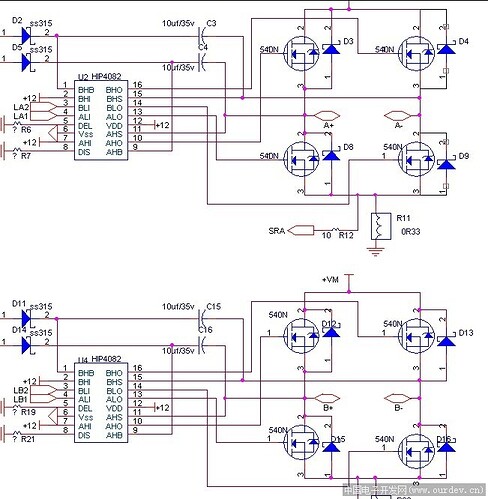

@Raschemmel: Of those designs you linked, several had additional diodes across the FET in the same direction as the built-in parasitic diode in the FET. Do you know why they would do this?
