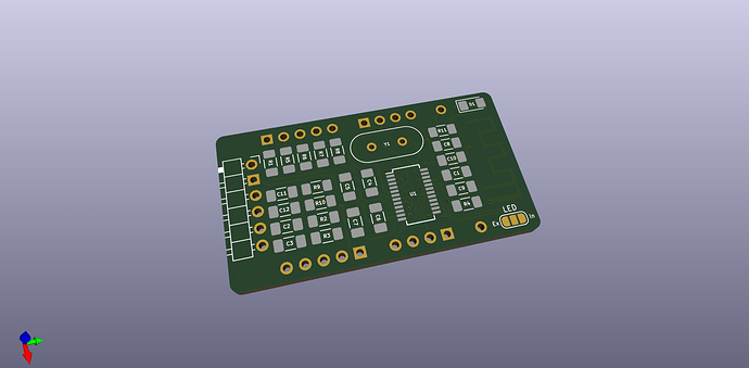

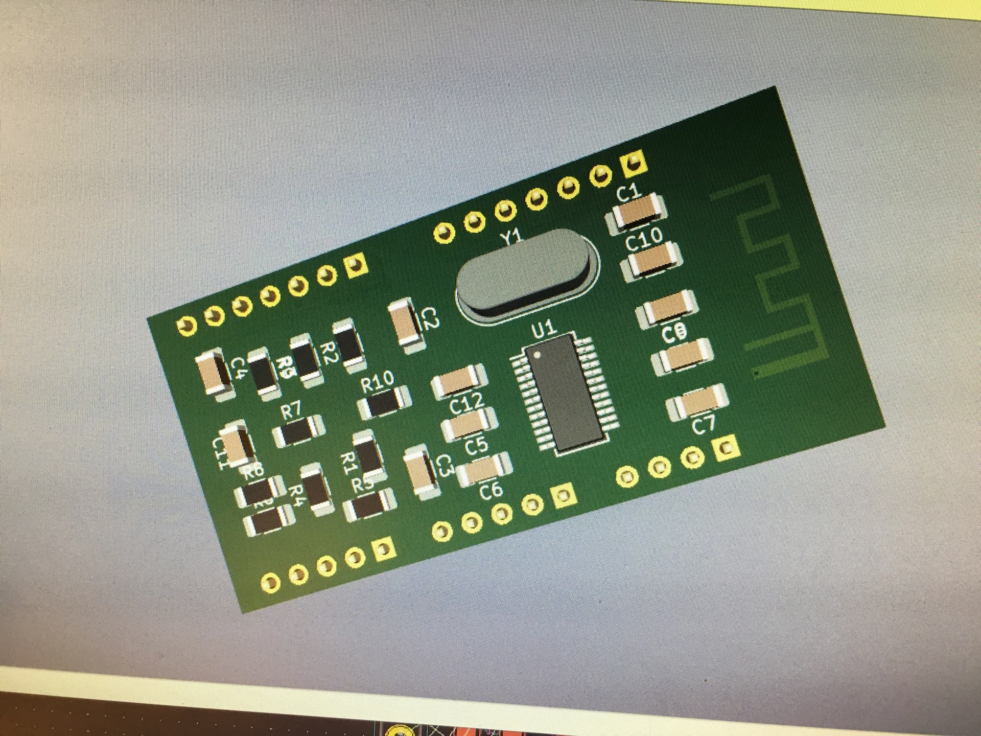

Can you share your schematic, and a top and bottom view of the PCB? If you don't want it public, you can PM me.
It is often useful to have mounting holes on PCBs and text labels on pins on the top of the board are helpful. Hiding component labels under the component may seem like a good idea until you need to quickly identify them after building the board. If any of the capacitors are polarised then I would mark the polarity and add a pin 1 marker to denote pin 1 of the IC and a polarity indicator to the diode pads
I don't know what the application is for the board but have you considered adding explicit test points to enable easy measurement of significant pins ?
You could increase the diameters of the via annular rings.
@outbackhut After I finish it I will post it
@UKHeliBob The board is tiny, 25mm x 45mm so not much space for marking on top, but plenty on the bottom
Same goes for mounting holes, no need it is meant to go into headers. No polarised caps. Marking pin 1 is a good idea. It is alternative breakout to some Bluetooth MP3 FM Radio board. I want to separate analog ground from DAC because the board they are selling everywhere has bad ground. I bought bare chips and can reflash them with latest firmware for this type of configuration
@LarryD made them slightly larger
Good.
Gives room for the hole if it is not drilled in the centre.
EDIT
Move the Silk Screen USB i.e. B off the pad.
yeah, i’m going to turn pin labels 90 degrees so it will be off it naturally as I lift it higher

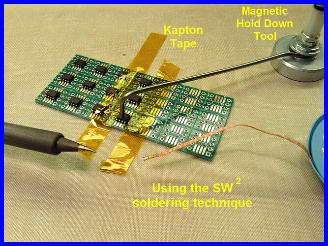

For hand soldering an smd component I put the component approximately into place then form two tiny balls of Blue Tac which are then pressed onto opposing sides of the component. Slightly varying the pressure applied to each Blue Tac ball allows the component to be moved accurately into place. Once tacked into place with some solder the proper soldering can begin. With tiny ICs (say 0.65mm pitch) bridge multiple pins then clear up with Solder Wick, one side at a time.
