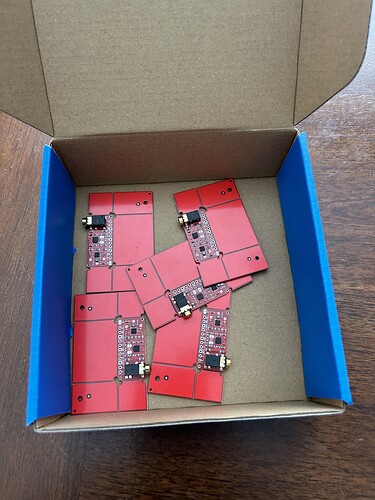

Ok now the quality inspection failed
Has anyone else been unlucky with JLCPCB?

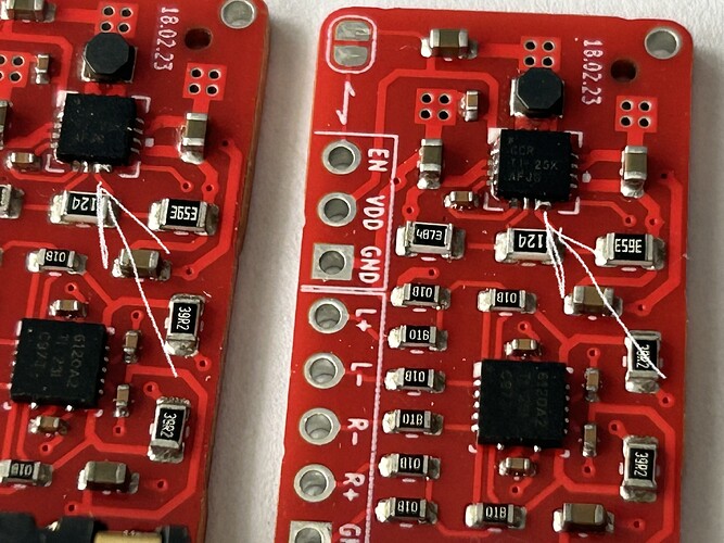

What are we looking at there? I can’t quite make it out. It does have my birthday as a date code although I don’t think that’s the problem.:grinning:
dodgy soldering, joined pins
