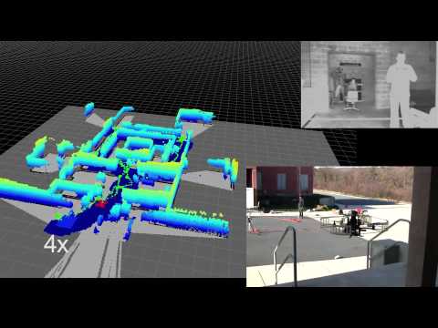

S.L.A.M. (Simultaneous localization and mapping). very neat:
