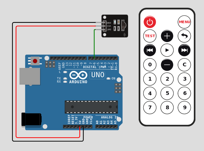

Who can write this code, I can't figure it out myself
6.4 Command – remote control, red and blue

We will assist you to write code. So show your attempt.
Please note that we have no idea what a9-in-1 shield is. Your text is talking about two images. So where are they?

A 9 in 1 shield with IR receiver and a red and a blue led: https://www.aliexpress.com/i/1005004504447306.html
I can not find a schematic, but here they say:
LED1 (blue): D13
LED2 (red): D12
SW1 (button): D2
SW2 (button): D3
DHT11: D4
Buzzer (either a passive piezo element or a active buzzing one): D5
IR Receiver: D6
RGB LED: D9, D10 en D11
Potentiometer: A0
LDR: A1
LM35: A2
2 Digital pins: D7 en D8
1 Analoge pin: A3
I2C bus: SDA A4, SCL A5
UART bus: TXD en RXD
The Wokwi simulator can simulate a IR remote and has leds and a RGB led:
Add a red led and a blue led in Wokwi, and find an example how to use the IRremote library. If that works, then upload that sketch to your Arduino board and it should work.
Why stop there ? Control the buzzer with the remote and the RGB led as well.
Who can write this code, I can't figure it out myself.
I can help... getting started is half the project...
