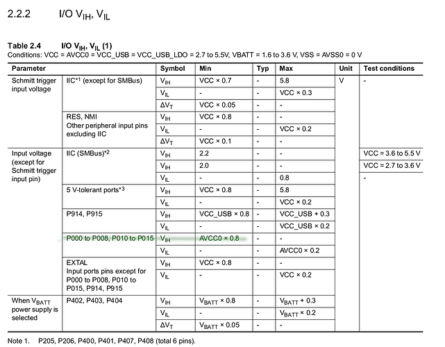

The switches are connected to the 3.3v side of the R4 board.
Why?
Question for the class: what is the numerical value of AVCC0 x 0.8 when AVCC0 is 5V?
Is that value greater than, or less than 3.3V?
