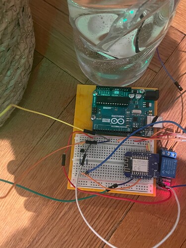

Hi, I've made this circuit for watering my plant automatically, and it is working fine. I am a total beginner to electronics and don't really know if I'm just lucky but after reading some articles it seems like most "professional" circuits use some capacitors or diodes, while I have not. Does anyone know how I could improve my circuit?

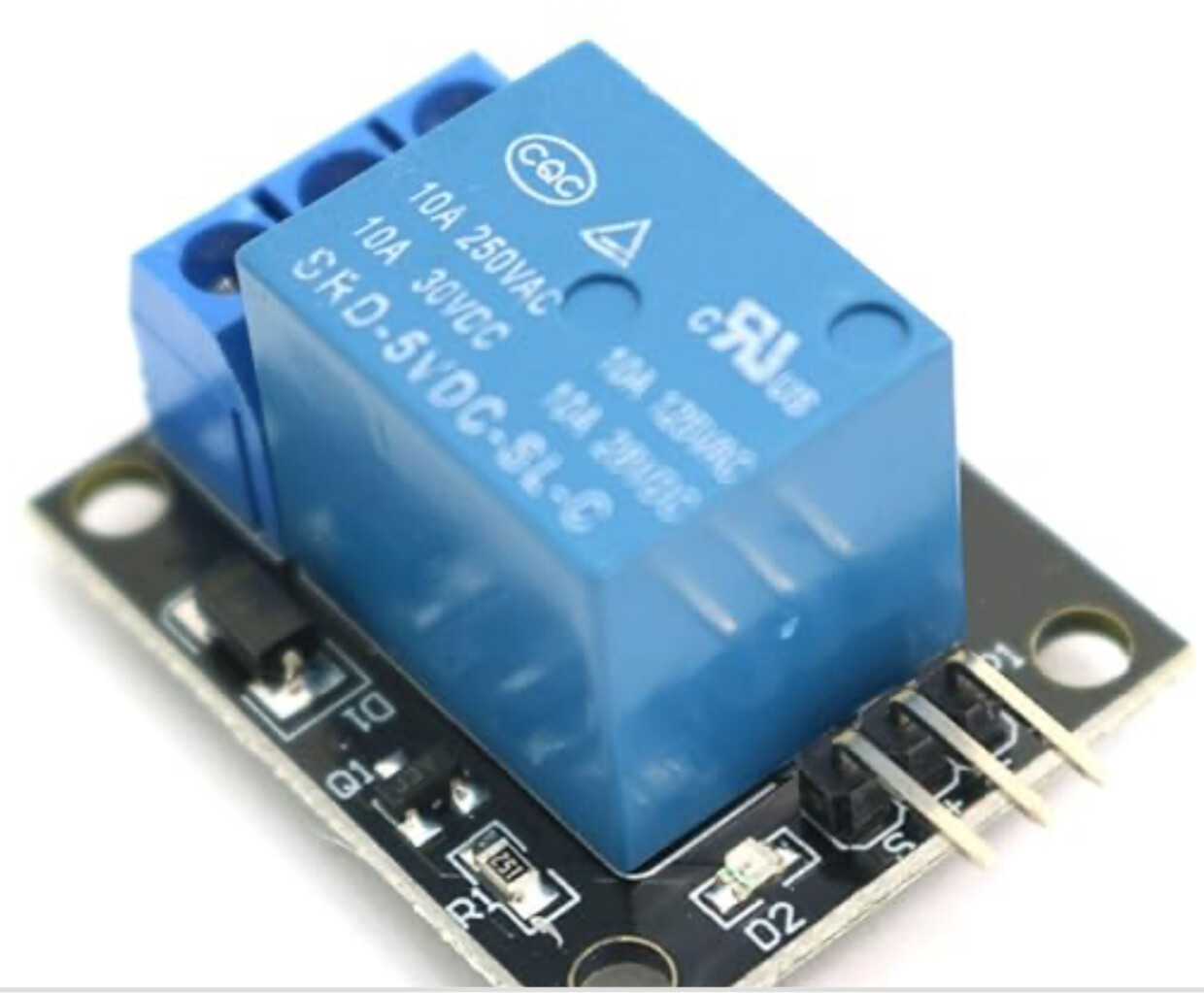

Also, the relay is a 5V relay and the DC motor is a 5V waterpump. I don't quite understand why the relay turns on when it gets a ground input. It didn't work with a 5V input (from the transistor that is).

Link to relay: https://www.amazon.se/DollaTek-KY-019-kanal-kortskydd-arduino/dp/B07DJ4ZD99/ref=sr_1_10?adgrpid=111850495843&dib=eyJ2IjoiMSJ9.523oRgLhG1qp_xsGAbPhluknKUbNI5U6hiQkpZ1ADYJdPq5F4qVi56Z1N73aRehQ1m-dGbP3CCh9bB3yHuyLBxFdqz6es4ZsJh0k3md4DCMR7JElzffVudbryyviez4JH2MrXDWoDsJKJvISI5AFTQfCaafUBwrt0ojdxIHTYv2dADmpdcKGq_kUjLCpHUeO5mEYRiZiQ84if3L5nBuMmplNLewzPfOcGP6UatNhhvwxcKSIysAg_3UuWvz_KKERW-9tufMwDo3dU4J5K62fJaM22amFK8Xs0tTgqnFNoM4.37SKaPxWueXuOPgRA-o4uZkmX7AclB_0URbOCf4bweE&dib_tag=se&hvadid=678397857751&hvdev=c&hvlocphy=9219639&hvnetw=g&hvqmt=e&hvrand=13882957924970332398&hvtargid=kwd-1188847092658&hydadcr=28121_2377794&keywords=arduino+relay+amazon&qid=1733768155&sr=8-10

  • Always show us good images of your ‘actual’ wiring.
    Show us your relay. Give links to components.

  • There is hardware here that is not in your diagram.
  • Those relays are usually LOW to operate.

do you mean your really is active when it gets a LOW signal ?
that's quite frequent (and has some technical rationale)
It does activate on a low signal, so ground counts as a LOW signal then I guess?

So I guess the ground provides a LOW signal then?
YES when you set a pin to LOW, its voltage level is close to GND Level.
  • Your relay module uses components in a way that needs a LOW to energize the relay’s coil.
  • There are some modules that are made differently and requires a HIGH to energize the coil.
  • In electronics, HIGH/LOW don’t mean too much.
    In some instances a HIGH is needed to make something to work and in others a LOW.
