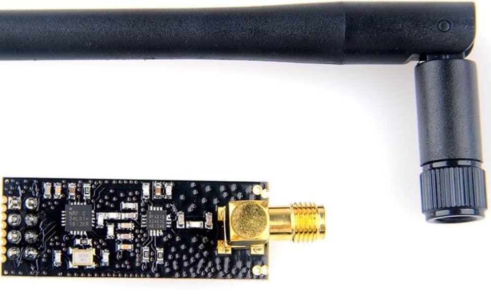

Why does nrf24l01 types only work with the +PA +LNA version?
Hello everyone, hope you are having a good day/night.
Whenever I use this type of nrf24l01 (the one with the antennas) it works:
But when I use this type it doesn't work, meaning it does not function, if it is a receiver it just prints out " " (even when the transmitter is off) or if it is a transmitter it does not transmit.
I tried them as receiver and transmitter but they never worked (they don't transmit or receive, because when I switch the nrf24l01 module to the nrf24l01+ PA + LNA it starts working again immediately.

I even tried using the nrf24l01 adapter that looks something like this:
No matter what distance I tried it never worked, and by didn't work I mean it does not transmit or receive anything. I am using room temperature to power the device which is about 28°C or 82°F, I'm using an Arduino nano to control the nrf24l01 modules.

Have you seen this troubleshooting guide?
I am curious as to whether your small RF24 radios are responsive to SPI commands etc, Are you able to run the included gettingStarted sketch and print out the debugging info per the link I provided on the non-working RF24s?
It tells me:
radio hardware is not responding!!
I even tried adding wrap foil.
That tells me that either you have a wiring problem or the modules are faulty. The radios cannot talk to the Arduino so you will never receive or transmit until that works.
Are you connecting them exactly the same as the working modules? If so I suspect bad hardware.
I switch the small nrf24l01 modules that don't work with the big nrf24l01 + lna + pa at the same time and then it works. So it is not a wiring problem.
If it is a hardware problem, where can I buy good nrf24l01 that function properly. (if it can be from aliexpress that's better)

Hello everyone, I have found the issue, When purchasing NRF24L01 modules, I have realized that there are mostly 2 types of nrf24l01 modules in Aliexpress even tho the listing says the same thing.
Let me show you the 2 types:
Type 1:
Type 2:
Both of them cost the same thing ($1.87$ per piece) even the name for both of them says "NRF24L01 2.4GHz wireless module".
You can see type 1 has white PCB lines while type 2 doesn't.
I have purchased both of them at the same time. And guess what? Type 1 works while type 2 doesn't, the same circuit the same everything but only type 1 worked for me. So I think maybe the problem is that type 2 (the one that wasn't working for me) has different software code or different wiring I don't know.
