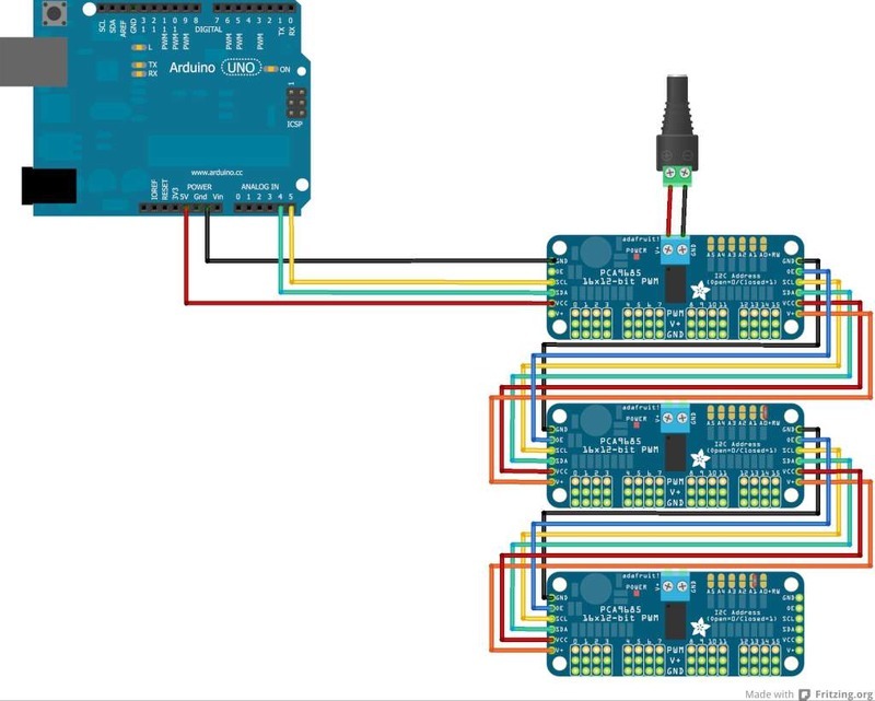

how do you power the servos ?
you can read this detailed info Overview | Adafruit PCA9685 16-Channel Servo Driver | Adafruit Learning System
thanks JML
all servos are powered Only the separate green jack in the middle of modules
V+ and OE are Not used
So I wonder a little, that in the documentation you told me, there is a 6-wire-connection between modules..at now, i had only 4 wires for GND, SCL,SDA, VCC..
so, i'll add 2 wires for OE and V+ anyways..,then test again
How do you get power for the second module if you don't have that ?
As per the tutorial, this would be the typical setup when you have multiple PCA9685
(I actually would wire the main Servo power directly to the extra modules rather than daisy chaining )

if you look closely at the pins
you have two power pins. One is for driving the logic components and probably the activity leds (Vcc) and one is for powering the servos (driving the output pin) V+
if you only connected Vcc then you did not daisy chain the higher power needed for the servos.
You need to bring V+ to the second board, either by connecting at the top with the screw terminal or by adding the V+ link between the two boards (meaning the full power needed by the second board will go through the copper traces of the first board - on top of what's needed for the first board - and that put more strain on the module. That's why I was suggesting to connect the power supply to the screw terminals in parallel directly)

hi,
now i have checked the connections between input and output side,
what are responsible for chaining..
I found, that on one board there was a connection between VCC-points,
on the other Not !
All other pins are connected, so i assume, this is the problem !
So i will wire the VCC-Pins externally and see, what happens..
will report later on, okay ?
hi
SUSCCESS ! This was it !
