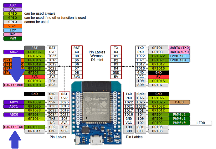

Really? I've been making my circuit based on this pinout diagram. You can see that pins 9 and 10 are designated as UART1 pins, pointed to with some big blue arrows. Do you know why this would be designated as UART specific pins if any can be used?
Don't believe everything you find online...
You can use almost whatever pins for UART1, to make it simple pick any from 16 to 33
Or if you like your pinmap image, use UART2, it has working default pins 16 and 17
