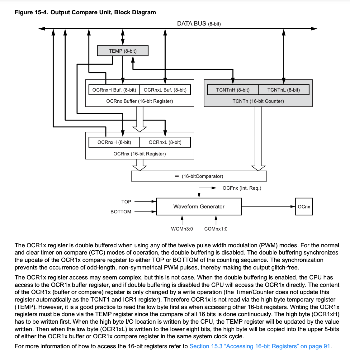

Why doesn't analogWrite() protect its writes to 16bit registers?
Continuing the discussion from What is the inverse of analogWrite(pin,val)?:
Do you need to protect reads and writes to 16bit timer registers, such as OCR1A, TCNT1, ICR1 ) from interrupts?
The Arduino analog core code at ArduinoCore-avr/wiring_analog.c at master · arduino/ArduinoCore-avr · GitHub writes to 16 bit timer registers like:

Why do they not protect the 16 bit writes as in http://ww1.microchip.com/downloads/en/Appnotes/doc1493.pdf or ATmega48/V / 88/V / 168/V or this section 15.3 from the Uno's datasheeet at https://ww1.microchip.com/downloads/en/DeviceDoc/Atmel-7810-Automotive-Microcontrollers-ATmega328P_Datasheet.pdf

The answer seems to be "Yes, if both the main code and an enabled ISR write to or read from 16-bit registers for that timer." The ISR doesn't have to worry about it since it is running with interrupts disabled.
Because the writes are buffered?
Interrupts should be disabled in setup() until a module is fully configured.
A) In the Arduino runtime there are no ISR's writing to or reading from Timer1 registers.
B) The value passed to analogWrite() is supposed to be between 0 and 255 so when that value is written to OCR1A or OCR1B the high byte is always zero. If you put an analogWrite() in an ISR the worst it could do is accidentally set the high byte to 0 when the main code was going to set it to 0 anyway.
So analogWrite(pin,val) doesn't need to worry about it for 8 bit timers, since those aren't 16 bits, and for the 16 bit ones in 8bit the default WGM=1, 8-bit phase correct modes, they're safe because the datasheet says "Note that when using fixed TOP values, the unused bits are masked to zero when any of the
OCR1x registers are written. "

The only way that a timer's TEMP buffer can screw up a write is if an ISR happens to corrupt it in the middle of other code by reading that timer's TCNTx or writing one of the same timer's other OCRnx registers.
I guess the reason why it doesn't protect TEMP is a tradeoff between depending on the default configuration and speed--it doesn't matter for fixed-TOP 8-bit modes, or when there are no ISRs that write timer registers. But if speed really mattered, you might depend on the 8bit config and only write the low byte like OCR1AL and save a couple bytes & cycles.
It's also interesting that analogWrite will work (** sort of -- 255 is still a full on digitalWrite!) to set pwm values higher than 255 in other modes. (e.g. 0-1023 resolution in 10 bit mode).
Remember that writing to OCR1xL causes OCR1xH to be written from the TEMP register. Do we know if the masking happens on the way into the TEMP register or on the way out? One way to check is to put the WGM into 10-bit PWM mode, write 0x0000 to OCR1A, write 0xFFFF to ICR1 and then write 0xAA into OCR1AL. Does the OCR1A read back as 0xFFAA or 0x03AA (or maybe 0x00AA by some magic)?

Well, besides the wokwi digression, I think the answer to my question about why they do not protect the writes, it that it is a balance between performance and safety.
The safety issues only come up if you are fooling around with writing or reading registers in interrupt contexts that may corrupt a particular timer's Temp register. It is interesting that reading OCR1x is not affected by/does not affect the TEMP register, because the read access is direct to the buffered or non-buffered OCRnxH byte.
If you do use or make use of interrupt code that might affect TEMP, you should protect your writes and reads, and analogWrite might not perform as expected. In particular, a corrupted TEMP could set OCRnx above TOP and the pwm would turn off.
