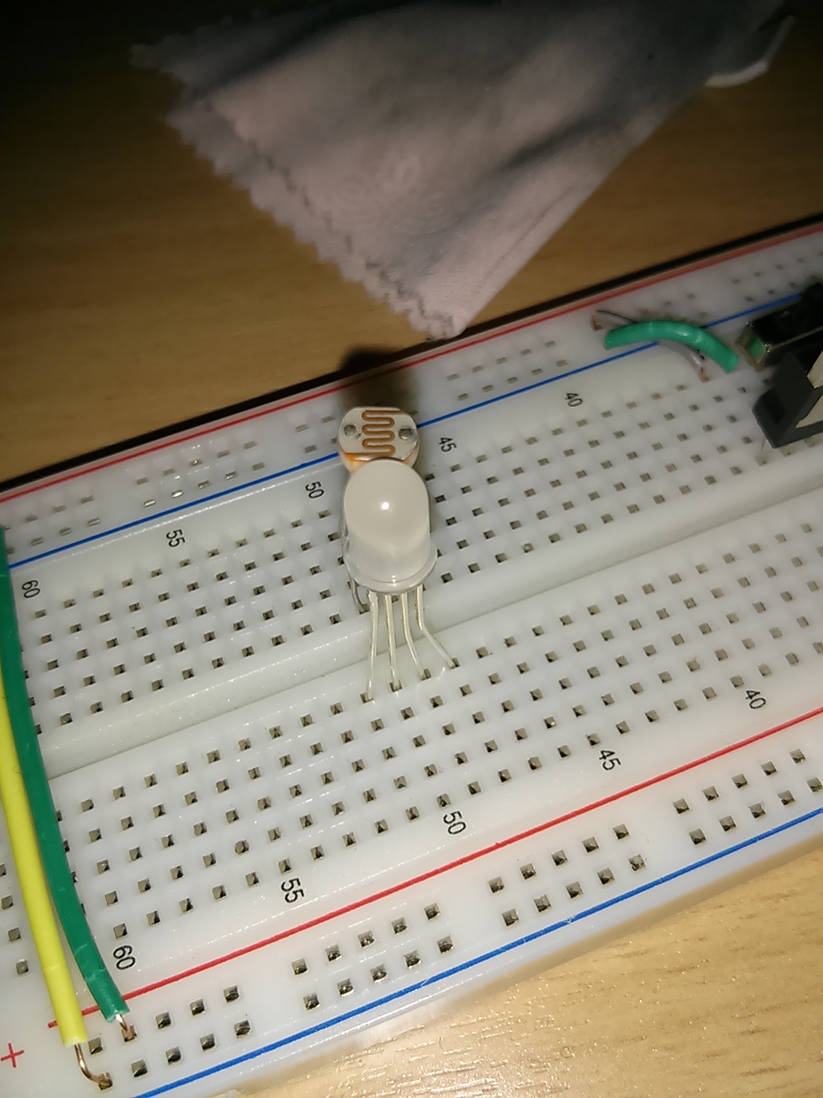

Why doesn't this detect color correctly? [Working now :)]
is was giving good results, until i changed something, it was 12am and i was really sleepy !
well first, i was looking somewhere and i tough, each colored object reflects its own color light better ! i went to try this and saw yes ! but knew for sure a lot of people tough of this already xD
i made this code

it always give me Green ! but when i put my finger or a red colored object it shows red ! is shows green when theres nothing on top of it!
it shows green still even when a blue object is on top of it !
here are results on console:
nothing on front :
Green: 235
Blue: 194
Red: 199

I just puted a phororesistor and a rbg led next to it !
Hi, first post your code between code tags # .
What are you using for sensors and can you post a CAD or picture of a hand drawn circuit diagram.
Also a picture of your project, to help us.
You need to check the colour response of your LDR they are not flat, also colour level output of tri-colour LED is also not necessarity flat, you need the specs of both.
Tom..... :slight_smile:
Photoresistor - part number? datasheet?
Is it a CdS sensor? CdS has a spectral response that's nowhere
near flat across the visible spectrum, it peaks in the yellow/orange/red,
very poor at the blue end.
BTW the human eye is no match for a colorimeter when determining if
a "blue" object is really blue or blue-green, since the eye's receptors
have a lot of overlap. And LEDs vary a lot from different manufacturers.
Without the spectral response graphs for your sensor, LEDs and the objects
under test there's no reason to suppose the values you get aren't entirely
reasonable.

i don't have any details about my parts !
im actually destroyed it for making a robot which, i abandoned because my breadboard is so big for robot chassis + my motors wont run with 4 1.2v batteries and faced many problems which mainly is power, i can't find good source of power
but heres picture of remade :
so simple !
i also tried putting a little paper between led and photo resistor, it didn't make any difference , it was so thin xD
but guess main reason is that 3 -color led doesn't have same light on each !
YAY ! i made it work ! but i found out even a slight diffrence in photoresistor's place makes a huge diffrence !
this is calibrated code for my stuff, i will work on an auto calibrate if anyone interested !:
