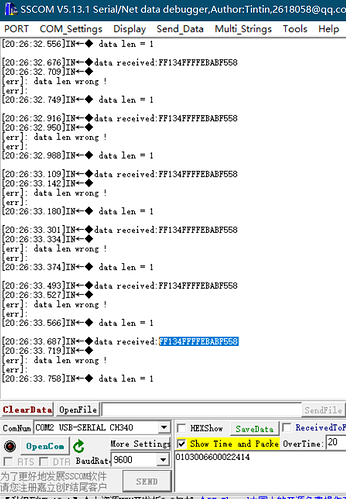

Hi, dear UKHeliBob,
i checked first Serial1.available() then read and set flag "dataReceived". i got "dataReceived" true because the statement afterwards was executed.
i disconnected my level sensor and now keep receiving "FF134FFFFEBABF558", refer to screen shot attached below.
"134FFFFEBABF558" seems good, however, where came "FF" from?
Regardless of how many bytes you receive you print 10 bytes from the uart_rec_buf array. Is that deliberate ?
actually, i expect 9 bytes. i just want to be confident all the data are received and printed when i debug my code.
the thing incredible is that i keep receiving "134FFFFEBABF558" now even i already disconnected everything from the MAX485 connected to Serial1.

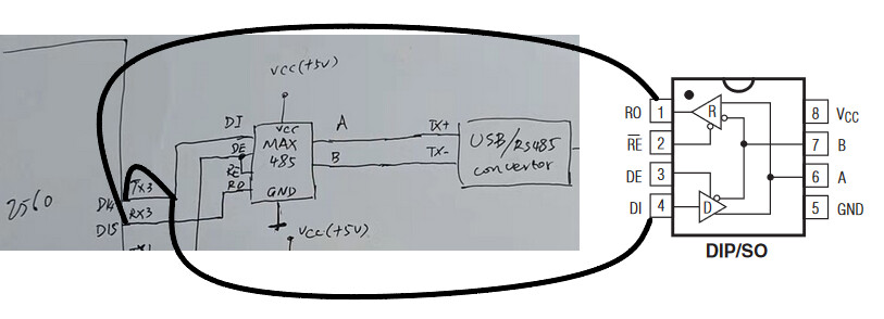

Crossed serial connections?
The labeling on your diagram is correct, but it's reversed top to bottom. Are the physical connections correct??
