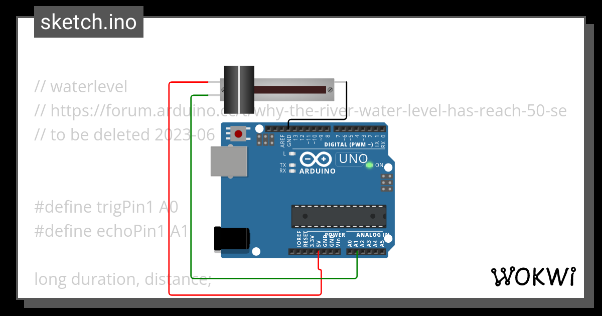

interesting artical on Liquid Level Monitoring Code Example using Time-of-Flight sensors
@MarshaJ847
first evaluate a state out of your measurement.
Send a messsage if the state has changed compared to the previous state
remember the current state for the next loop.
one switch makes it clearer then 4 if statements.
I might get confused with your messages, but imho it does what it should do.
just replace the ADC function with a HC function
// waterlevel
// https://forum.arduino.cc/t/why-the-river-water-level-has-reach-50-sending-too-many-message-but-others-send-correctly-one-time-but-only-this-message-sending-too-many-time/1064934/4
// to be deleted 2023-06
#define trigPin1 A0
#define echoPin1 A1

Simulation in Wokwi for a limited time:
