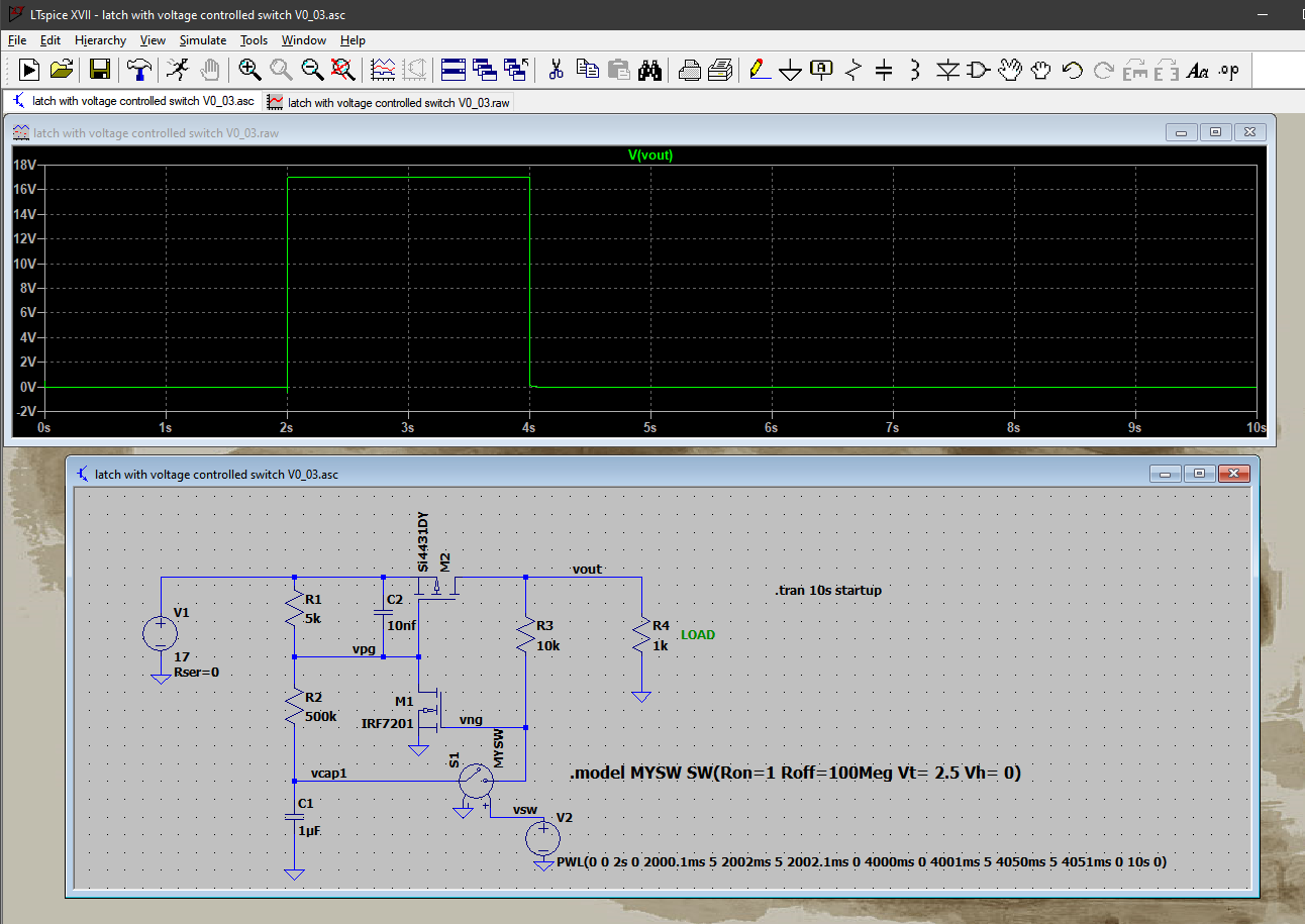

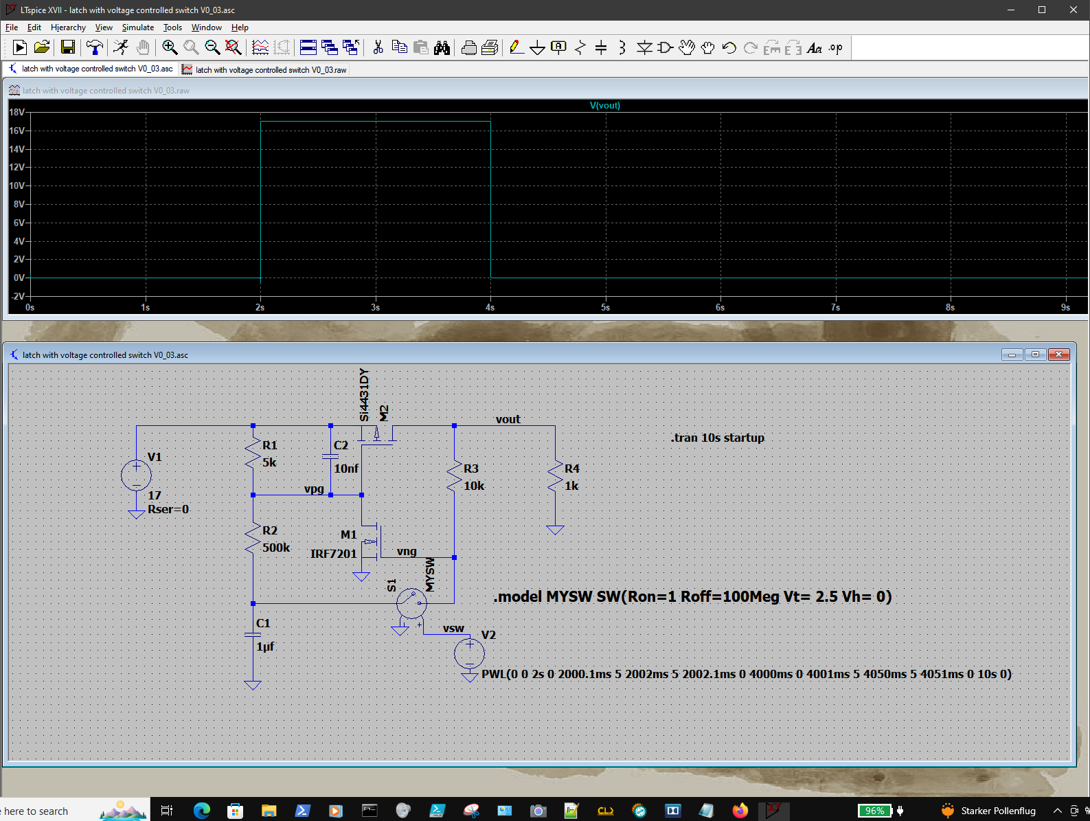

The component values for that circuit appear very critical. I used LTspice to simulate it covering the power on, press 1 of the latch to power the load and press 2 of the latch to switch off the load. I haven't got a model for that mosfet IRF7319 so I attempted to find something similar and modified some values (also added a small capacitor). The output voltage reaches the input voltage (17 volts).

I won't explain it in detail because that is probably the exercise you have been given (and anyway I would probably not make a very good job of it).
What I can do is give you the LTspice file as an attachment and LTspice is free to download but is not in the same league as Proteus (which you clearly have access to). However you do it, you have to watch the 3 phases, that is (1) start up, (2) the first press of the switch to latch the circuit on, and (3) the second press of the switch to latch it off. You can zoom in to a granularity of a few microseconds at these critical points. Most of the complexity was in parametrising the voltage controlled switch and finding mosfets which had a reasonable similarity to the IRF7319 (dual N/P MOS). Also, and probably most difficult, fine tuning the component values to allow the circuit to power up in the off state with only a 1k load. See also here: mosfet - PMOS Turn-On due to gate capacitance? - Electrical Engineering Stack Exchange

LTspice file
latch with voltage controlled switch V0_03.zip (858 Bytes)

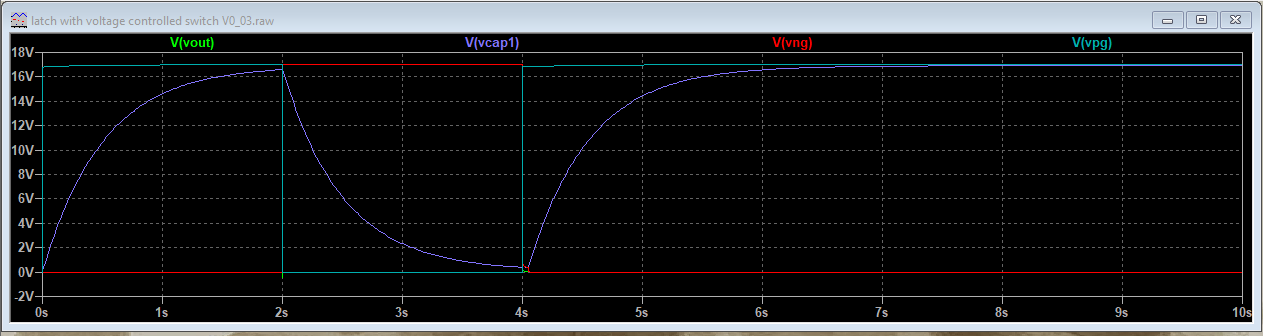

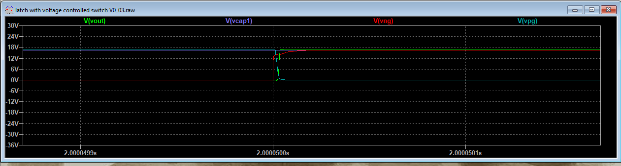

Full 10 second time line with only output voltage shown

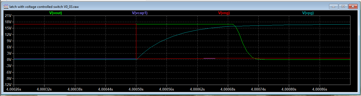

Several sample voltage measurements across the range

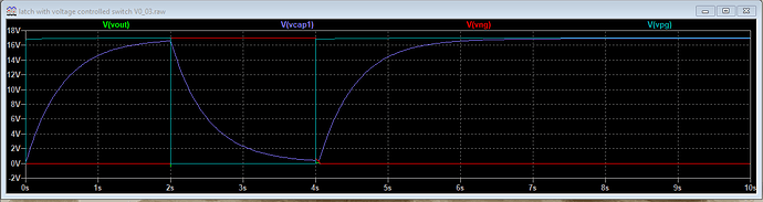

The first 50uS

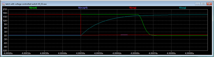

Latch on

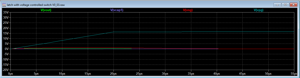

Latch Off
