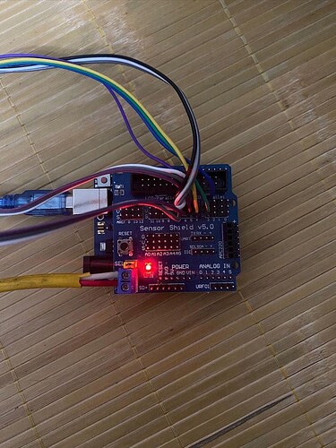

Why won't my Arduino run the program except when I plug it into a laptop?
I have a 5V-10A power supply for the Arduino to run a robotic arm and control it via Bluetooth through my phone using the HC-05 module. However, when I disconnect the connection between the Arduino and my laptop, I am unable to control the robot arm anymore. I'm not sure why this is happening. Please help me.
Part list: 5V-10A power supply, Adruino Uno R3, HC-05, Robot arm with 7 servor MG996r.

Here is some image:
Where do the servos get their power from ?
Please post a wiring diagram.
Is that external voltage going into the top 'shield' there just available for the motors; not available, separate from '5V' (supplied from USB)?
Sensor Shield V5.0 - ProtoSupplies
I edited the post and added wiring diagram.
They get from 5V-10A PSU, big yellow wire
But, a fictional diagram... there is no shield shown. Or any big yellow wire... however it does look like the answer is in the shield config.
I will make one soon.
Pull the yellow jumper first.
I just edit again, do you know what wrong with the shield and how to fix it?
Sorry, I'm having trouble trying to understand what you mean. English is not my strong suit. Could you please explain the problem in more detail and provide instructions on how to fix it.
I saw it in the photo. I'm referring to the diagram. But, I think you've hit on the solution, if the OP will acknowledge it.
Consult the sensor shield documentation. Use machine translation if you don't understand, but there should be diagrams there to help...
"how to fix it"... see reply #11, it's labelled "SEL"
Thank you.
