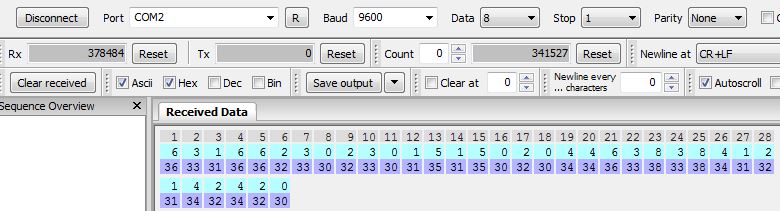

Right now i have my RFID-Reader connected to a Tibbo WLAN to Serial converter.
The Tibbo gives a COM-port on which i can connect with a terminal program.
When i swipe a RFID Tag over the reader i get "010D68F03C" back from the Tibbo COM-port.

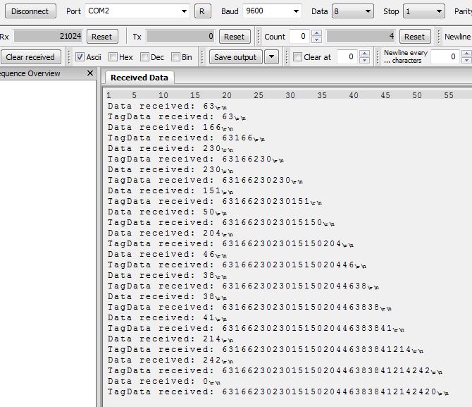

When im hooking up the Reader-Data-Output to my ESP8266 with the code below i get:
--> "631662302301533023062502422022142420"
HEX: 36 33 31 36 36 32 33 30 32 33 30 32 30 33 35 30 32 30 34 34 36 33 38 33 38 34 31 32 31 34 32 34 32 30
DECIMAL: 054 051 049 054 054 050 051 048 050 051 048 050 048 051 053 048 050 048 052 052 054 051 056 051 056 052 049 050 049 052 050 052 050 048

I attached the Data that i get from the Tibbo Serial-Wifi Converter "010D68F03C".
And the data from my ESP8266. "631662302301533023062502422022142420"

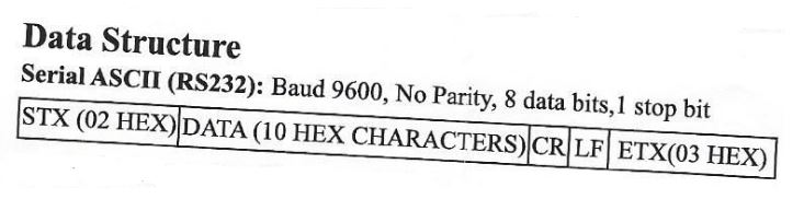

Regarding to the reader data format i should get at the start an STX (0x02).
At the end i should get an ETX (0x03).
But i dont even get that in my stream. I´m a little stuck.

The format that i should get from the Reader is as an attachment .jpg in my first post.

      while(readerSerial.available() > 0)
         incomingData = readerSerial.read(); // <------------------------This is the stuff that reads out the RFID reader
         Serial.print("Data received: ");
         Serial.println(incomingData);
         TagData = TagData + String(incomingData);
         Serial.print("TagData received: ");
         Serial.println(TagData);

In the attachment you can find the Serial output of:

Please do not post pictures of text.
Since you know that there is data to read, the data CAN be stored in a char or byte type variable, instead of an int. Doing so might just make handling the data more intuitive/obvious.
The data coming in is not in the ASCII character range, so trying to make a String of it does not make sense. You will never make the String match anything on the card/chip.
On the other hand, why do you need to? You scan a card. You get an array of bytes. That either matches a known array, or it doesn't.
So the reader is working and outputting an ASCII coded string.
Looking at the other strings i see no evidence of that card being present.
I suspect the problem lies with your tibo system.
The quoted format from the reader is 14 bytes.
You have 34 bytes or blocks being read.
Have you updated the firmware of your ESP8266 to operate as a data bridge ?
Just poking serial into its inputs is unlikely to work.
