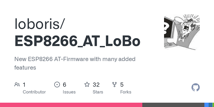

I use this:
With this:
https://www.amazon.com/gp/product/B07B1X6LSF/ref=ppx_yo_dt_b_asin_title_o05_s00?ie=UTF8&psc=1
With this library:
...and the ESP8266 has been flashed with
Yes, lots of steps...but it is cheap, fast, reliable and supported by current development.
