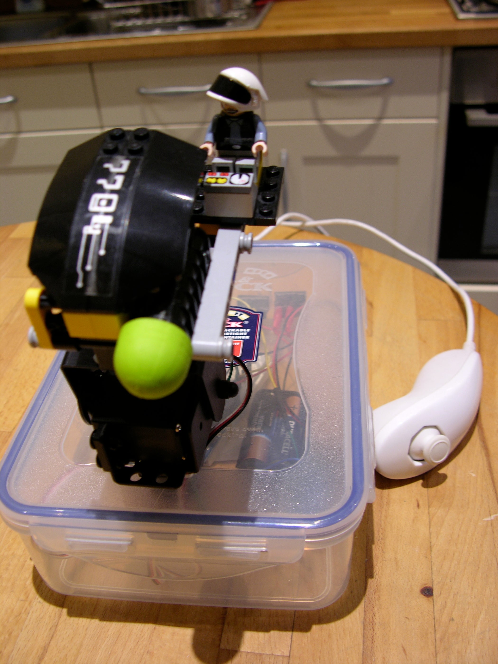

I'd just like to thank the OP for the idea and sketching out the schematic. I put this together last night for fun, and already have some ideas.
I had a quick look at the code and made a few changes to correct the reverse pitch axis and rotation distance.
  if( myWiiNunchuck.cButtonDown && ( myWiiNunchuck.zButtonDown != myWiiNunchuck.cButtonDown ) )
    pitchServo.SetRotation(-(pitchServo.GetCurrentRotation()));
    pitchServo.SetRotation(-(yAnalogPos));
(reversing rotation angle at time it is sent to servo)
 ServoControl(int pin, int neutral = 1500, int range = 800) : (extends the range of motion on the servos. On mine, both axis go the full swing in one direction, but only about 80% to the other)
Hope this helps some people.
I'm using this sketch to make a wii controlled water shooter. My nunchuck was giving me opposite movement for yaw (x) so fixed it with this small change to the code
yawServo.SetRotation(-xAnalogPos);
