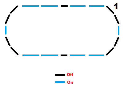

I'm new to Arduino and kinda lost in the dark with what type of microcontroller I should use. I have the basic idea of how program them and using Mosfets with them to power large amount of leds. The type of thing I want to do is making large amounts of LED flash on and off repeatedly. Have been using 555 timer chips to do it, but I like taking it to the next level and be able make custom flash speeds and flash patterns.
The only way I can think of showing what type of patterns I want is with a GIF image. I'll post a link to one and try upload one with this post. I'll also upload image showing how many led being used in each set of LEDs shown in the GIF image.
Link to gif image number top right of the photo is the flash pattern. There total of 5

file name ledlighbar.png is the amount of leds being used
Thing making Led light bar goes on top of a car
Would Arduino work for me or should I try something else?
If it would what type of Arduino should I use? looks like I need 16 outpins
