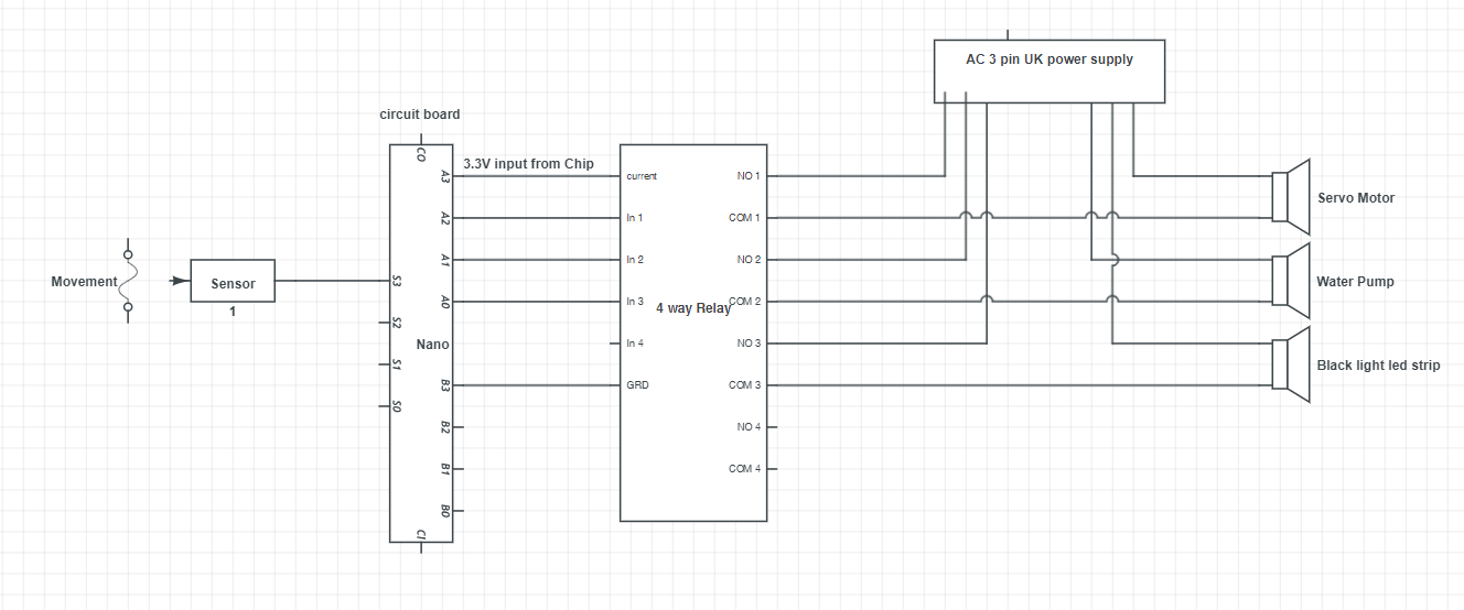

I have the nano ESP32 and I am looking to have a movement sensor to trigger a sequence of events, firstly activating a servo, then activating a pond pump and a strip of LED black lights, letting them run for 15-20 seconds, then stopping the pump and the lights and the servo returning back to the original position, then a delay of 30 seconds before the motion sensor is able to trigger the sequence, I have this as the circuit for the project, is it right or am I really wrong? I am struggling to find anything that shows how to connect a relay to a UK 3 pin plug for mains power.
Edited to include the components I have also
PIR motion detection sensor compatible with Arduino
I have 2 - 4 channel relays with trigger - 5V and 24V Maximum load on both is AC -250V / DC 30V.
LED lights - 12V
Servo - 7.4V
Pump - 220V

Each motion sensor will need either Analog In (AIN) or Digital I/O (DIO) pin from the Arduino to signal motion was detected. Your code can accept or reject other (unwanted) signals. The sensor will have a distance-from-Arduino limitation, and might need external power from a power supply.
The servo might need one PWM (or DIO) pin from the Arduino for control. The servo will receive external power from a power supply.
The water pump will probably be DC, switchable with a single relay, the relay will be controlled by a DIO pin from the Arduino. The relay would need external power from a power supply.
The LED strip (I am not aware of a blacklight LED strip, or UV, just visible light) will use one DIO pin from the Arduino for control, and use an external power supply.
The external power supply must handle all devices at full use, plus a little, to keep the power supplied stable.
All ground pins will be shared (Arduino, sensor, servo, relay, LED strip, power supplies).
Arduino can supply power to light-use devices (for example, the motion sensor) but not devices with larger power demand.
Calling 'ween experts @hallowed31 @Terrypin

What is your experience with Arduinos and electronics?
What sensor are you using or planning?
I don’t follow your schematic; is it your own?
Is your main question about controlling the 240V AC UK mains supply? What relay do you have or plan?
What code do you have so far?

A PIR sensor? It works like a regular pushbutton if you set the jumpers on the back correctly.
In the sketch I'm about to post, you don't need anything hooked up except a button to ESP Nano pin 2 (I've never used one, I'm assuming it's a GPIO but if not, change the pin 2 to a GPIO for your board).
It's based on example sketches blinkWithoutDelay and stateChangeDetection and I implemented a state machine (the `switch (buttonState)` down to its closing curly brace) to mash things together.
This is a hands on hobby and you trying out this sketch will be better than my explaining it to you. It has parts relevant to what you're doing (as do the next two sketches that you'll sort of Frankenstein together to get what you're after).

Hello I did an AS level in electronics back in college but things have moved on considerably from there, I am wanting a skeleton to lean forwards and then the pump to activate and the skeleton to be sick, the blacklights will light up the fluorescence in the water to make it glow.
I have 2 - 4 channel relays trigger - 5V and 24V Maximum load on both is AC -250V / DC 30V.
LED lights - 12V
Servo - 7.4V
Pump - 220V
I want it to all work off 1 power supply, that I can plug into the wall.
It is my own I saw someone say you should try and do it like that as it makes it easier for others to follow.
I am looking to see if I have the circuitry correct as I don't want to put it together and blow everything, the code I am quite confident with.

Thank you, with me connecting all of the devices to a UK power supply, we have AC, the pump is AC and wanting to know are there any extra steps I would need to take? the plug will have a fuse so will cut out if it overloads for any reason.
Components:
LED lights - 12V
Servo - 7.4V
Pump - 220V

Thanks, understood. All you describe is doable. Given your relative inexperience I recommend you tackle it in stages. Begin with getting the PIR sensor just lighting a simple LED. This is one of several popular PIR sensors that should be suitable. I'd buy more than one.
[https://www.amazon.co.uk/HiLetgo-HC-SR501-Infrared-Arduino-Raspberry/dp/B07KZW86YR](https://www.amazon.co.uk/HiLetgo-HC-SR501-Infrared-Arduino-Raspberry/dp/B07KZW86YR)
Even when we've seen a clear specification, we're usually reluctant to just design a circuit and code for copy/paste until we see how committed you are yourself. So show us your work on that first bit, then we should be able to help you to get your project up and running within the 15 days remaining.
**EDIT** : All the steps are summarised succinctly by @xfpd in post #2.

> [@Delta\_G](#):
> Do you normally feed that directly to a servo? All the servos I've ever used around Arduino took DC.
I'm pretty sure the servo is DC - it's just the circuit diagram that confuses the issue.

That’s why I asked the OP about the relay in post #3.
@natas908 has now clarifed in post #10 that it's for a mains powered pump.

> [@natas908](#):
I use fear of death as a motivator when working with A/C and water. My house has a water (sump) pump powered by A/C, but is activated by an energized DC relay, which is powered by a transformer (AC to DC). The DC relay is activated by a water sensor (shorting probes) in a drain pan. All COTS products.
This guy did a crazy-good water project (sadly, the video is down)

Hi Thanks for the advice,
I am going to give it a go myself just knowing that the logic is sound I can figure out the rest and come back if I really do get stuck 😃
