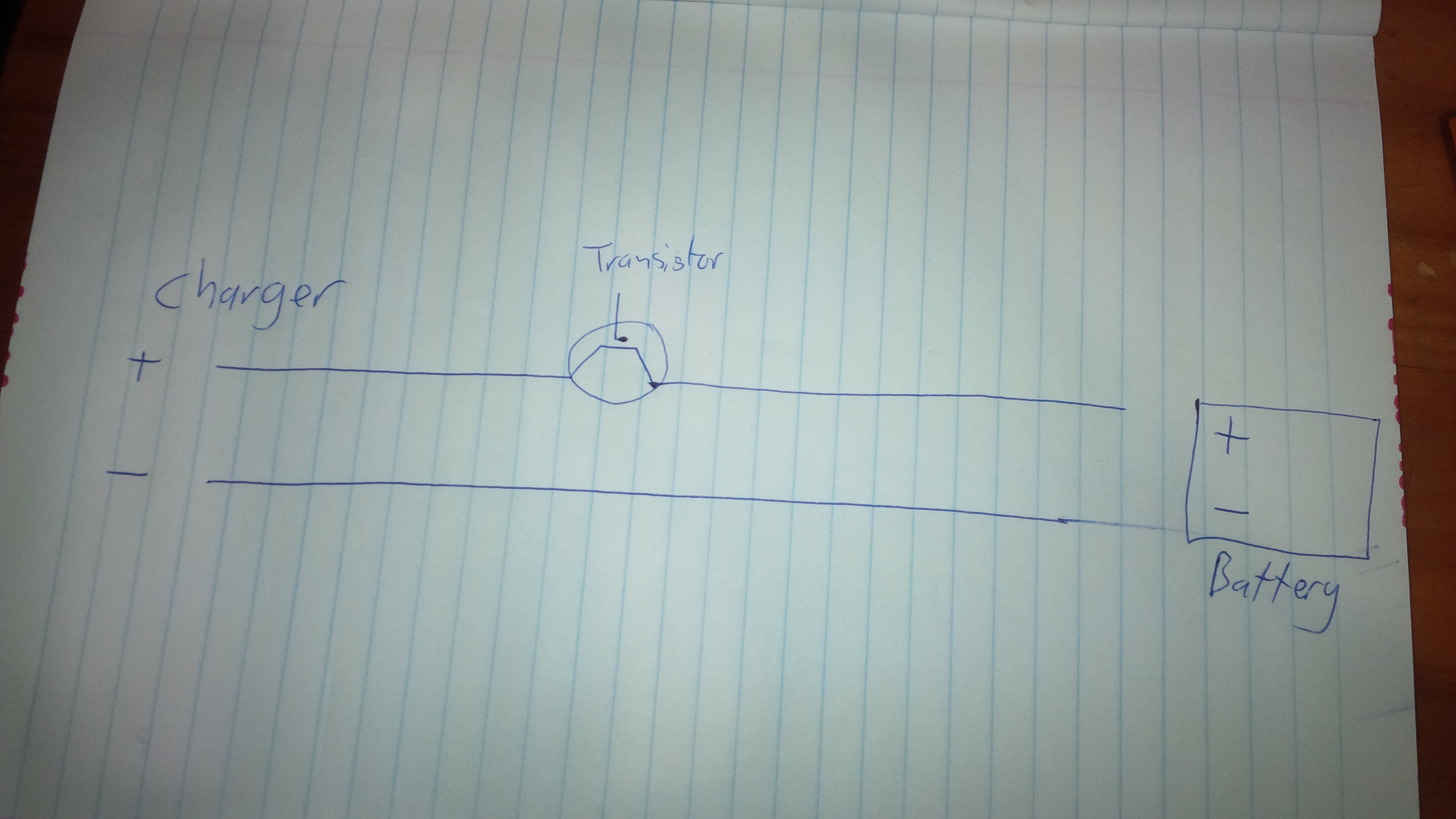

I want to use a transistor to switch a battery charger off? Like in my diagram bellow? Will this work and what type of transistor do I need?
It's confusing for me because I don't know if I must do high side switching or if I treat the battery as the "load" or what?

Yes, use P-channel MOSFET like that for high side switching.
Or use N channel on the other leg for low side switching.
What will turn the transistor off & on?
If a 0-5V signal, then be sure to select a Logic Level MOSFET.
Want Low Rds so it does not heat up and dissipate power as chargng occurs.
What voltages and currents are involved?
(BTW you seem to have drawn an IGBT symbol of unspecified polarity - did you mean this?)
Yes I meant to draw it like that cause I don't know what type of transistor to use.
Ok I have connected an PNP transistor and im driving it with an NPN. I have a weird problem though. If I switch the charger on without the battery connected, the resistor from the base of the PNP to the collector of the NPN gets smoking hot and burns out. But when I connect the battery then it doesn't get hot? Why is this?
I have used a 1k resistor between the NPN collector and the PNP base and a 1K resistor as a pullup resistor for the PNP base.
The current is 250mA and the voltage is 29volts. The transistors I'm using is a P2N2222 and a BC327

With 29V flying about you have to calculate resistor power dissipations and choose
suitably large packages as necessary.

Without a battery hooked up there is nothing using up the power going into the resistor, that power must go somewhere so it is released as heat. Its like beer, if you drink alot of beer but don't go pee, your bladder gets full and you do the pee-pee dance. Well your resistor is drinking beer, and is doing the pee-pee dance.

Ummm... too much power going through it.
You know how to calculate power, right? We did it in the other thread.
First you calculate/measure the current going through it, then you multiply by the voltage across it. It doesn't take too many amps to heat up a resistor when you've got 27-28 volts across it.

Ok understandable, maybe easy for you but not easy for me. I know, I think I know, that the base of the PNP has not got 27volts across it. The emitter and collector has 27volts across it but not the base. So if I ground the base of the PNP transistor how can 27volts be across the base? I thought a transistor uses small amounts of voltage across the base to allow large amounts to pass through the emitter and collector?
