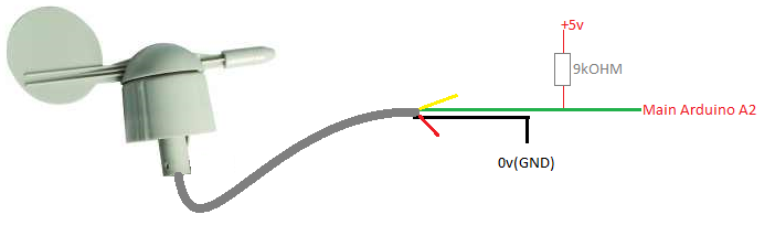

I am in the process of making an Arduino powered Weather station, now it's time for Wind Direction.
I have what i think is a MAPLINS type Wind Vane which has 8 Reed switches, all with different resistor values, does anyone know how this works, i have had it on a DVM and there seems to be not only a signal from each Reed switch, but also from in between the switches, ie the magnet is making two switches simultaneously, can this be right?

Sensor in the wind vane diagram could be the same. It has 16 possible positions.
If it's highest resistance is ~40k (as in the editor table), then connect the sensor to an analogue input and ground, with a ~20k pull up resistor. And read the analogue values in all 16 directions.
map() or if() statements could translate those values into wind directions.
Leo..

Many thanks for the info, it looks identical to me. Just one other thing, my weather vane has 4 wires, Red, Black, Green & Yellow,would i be right in saying to disregard the Red & Yellow, use the Black for Ground and the Green for signal, if thi is right would you put the resistor on the Ground or the Signal, i have uploaded a ping, this is how i have been connecting it.
Ray

I don't know what's inside YOUR sensor.
You should measure it's resistance in all wind directions.
Value of the pull up resistor is not critical, but you get the best separation in values from the A/D if the pull up resistor value is about half of the highest resistance of the sensor.
Then you have to use a test sketch to see the A/D values you're getting in all 16 directions, so you can use them in the if() statements of the final sketch.
Leo..

Hi Ray,
I use the wind direction sensor from Maplin in my weather station also. You can find my code & schematic here. I used a 4K7 pull-up resistor fed from an Arduino pin so that I can enable the pull-up for an instant, take the analog reading & disable the pull-up, to save battery power.
