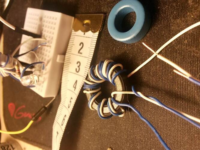

I built the simple Joule thief.
Parts:
  • Transistor : 2N2309 - 1 pc
  • Rezistor: 1 K/ 0.5 W - 1 pc
  • LED: white, 5 mm - 1 pc
  • torroid core, 1 cm diameter, white ferrite - 1 pc
  • cables- 0.5 mm D: 2 pcs @ 30 cm each, blue and white
  • minibreadboard - 1 pc
  • Battery NiMH AAA, 1.2V - 1 pc (alternatively: pile AA, exhausted)
Now it comes the strange part: a slightly larger blue torroid core, of 2 cm D, 80 cm wrap same wires did not work. I went down to 40 cm wraps - no chance LED did not light.
In one example it was a picture of a blue ferrite ring - looking quite the same I used and did not work.
Searching for ferrite cores I found tons of info about a zilion types of ferrite rings but nothing clear about what the colors mean. Somewhere I found that some types have more permeability than the others, which sounds somehow trivial.
Supposing I will end up with a suitable more efficient circuit, then how I can be sure I can order the same type of ferrite cores?
Thank you very much for any tip, kind guidance or pointing to a more friendly web-site!

falexandru:
I am trying again.
I have no idea why it did not work first time. Just do not understand.
Do you know what the black dots mean, they are more important than core type/permeability ?
They mark beginning of the winding, I think you connect wires not correctly.

Yes, I've gotten away with just using toroids designed to be used as RFI filters, when making Joule Thiefs. I know very little about designing inductors, and I've had little problem getting Joule Thiefs to "work". Do they run at optimal efficiency? Who knows. When I'm doing this stuff, I'm in full-on hobbyist mode :slight_smile:
So, like Ted said, you probably didn't get the wiring right. Just switch the wires on the primary, and try it again [or on the secondary]. I.e., make sure it's hooked up like the diagram Ted posted. Also, I've found it seems to work best when the turns ratio is 1:1. Example: if there are 10 turns on the Primary, then make sure there are 10 turns on the Secondary.
Also, it helps if the toroid is meant to to be used for RFI filters with a max current flow greater than the kind of current the Joule THief will be running at. If it's just driving a simple White LED, then we're talking around 20 to 30mA. Also, the toroid should be able to support frequencies up to a few MHz.
Now, I'm sure my more inductor savvy piers are going to jump all over me [and go ahead], but I'm just trying to give you "seat of the pants" hobbyist pointers [you know, like, "hey, this toroid that I bought from Electronic Goldmine [with no discernable parameters other than it's for making RFI filters] looks big enough for this application, lets give it a try!"
I wrap the 2 wires (blue and white) together, in the same way in the case of white ferrite and blue ferrite.
I connected the white wire of one side to the blue wire from the other side - this is the common end. Then I used the remaining wires to connect to the circuit as in the schematics.
I unwrapped and wrapped again starting opposite direction. I used grey ferrite core. I switched the ends. No way. Silent LED.
One moment I thought there is very low inductance in blue ferrite (for unknown reasons), so perhaps more winding would help.

Show the picture
Here it is the pic:
  • background: the circuit which works ok
  • grey ferrite ring - which does not work (wired)
  • blue ferrite ring which does not work
The length of the wires in blue and grey cases were 80 cm and then 40 cm.
The length of the wires in the white ferrite ring 30 cm.
Add 1uF capacitor parallel to resistor
