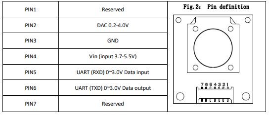

I bought a Winsen ZE25-O3 brand gas sensor.
I want to use it with Arduino uno.
Pin description is written on the datasheet of the sensor (I uploaded photo.).
I downloaded the library from the link.
Now the pin matches will be like the photo I uploaded the link below, right?
No. The UART pins are only for 0-3V but the UNO uses 5V on them. This may have damaged your sensor.
As you failed to post your code we cannot help you any further.
